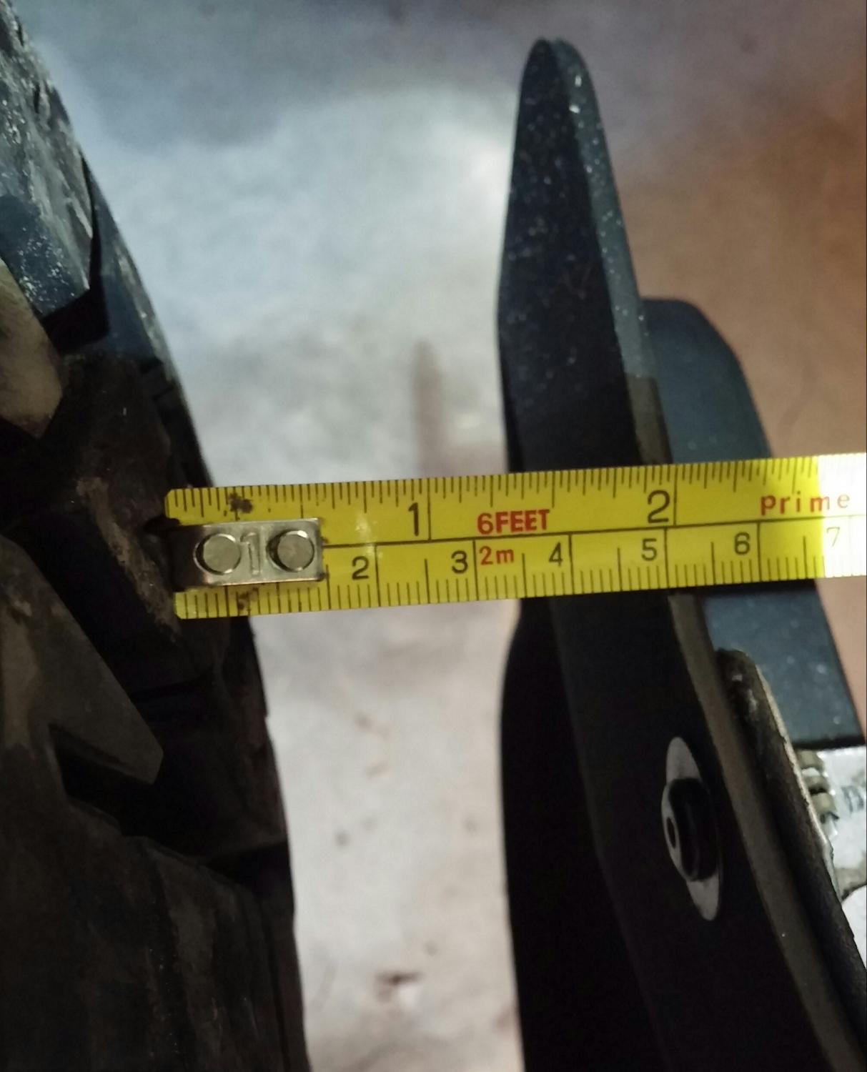

Who knows if this would cause any sort of vibration but I found this a little odd. Maybe it's normal or within spec who knows but I thought I'd share. It finally warmed up enough over the weekend so I could put my mud flaps on when I noticed on the rears I had a harder time fitting my fingers and hand in behind the wheel on the passenger side trying to put the screws back in the wheel well. So I took a measurement and found the passenger side rear wheel 1cm closer to the back of the wheel opening than the drivers side. I verified the 1cm difference measuring towards the front of the wheel openings too. Anyone else ever notice this or care to take a quick measurement on yours? What do you guys think of this?
That has to be the craziest thing I've seen :nonod:
I don't see how that could be in spec's, but then again the wizard ( GM engineer )
thought that if they loosened all the body mounts and re torque them that would
make the vibration between 62 & 75 disappear :nopity:
I would take the truck in for alignment and make sure that the rear axle is properly mounted on the spring seats. It is a rigid axle and if it not mounted straight, then you will have issues. 1 cm (3/8") difference is a bit much.
Edited by pm26
There are quite a few places to get a 3/8 difference between bed mounts and maybe even the sheet metal. You should measure from a place on the chassis to the wheel to get a true measurement.
