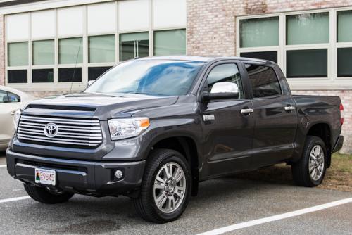

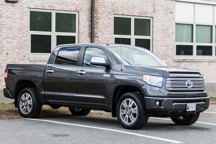

Sorry Jesse
Thought I had posted some. I need to get a few new ones now that it is all done up the way I want it. But this is how it looked right off the lot.
2016 Tundra Platinum Edition in Magnetic Grey Metallic

Sorry Jesse
looks sharp, definitely post it now that you've had work done!
