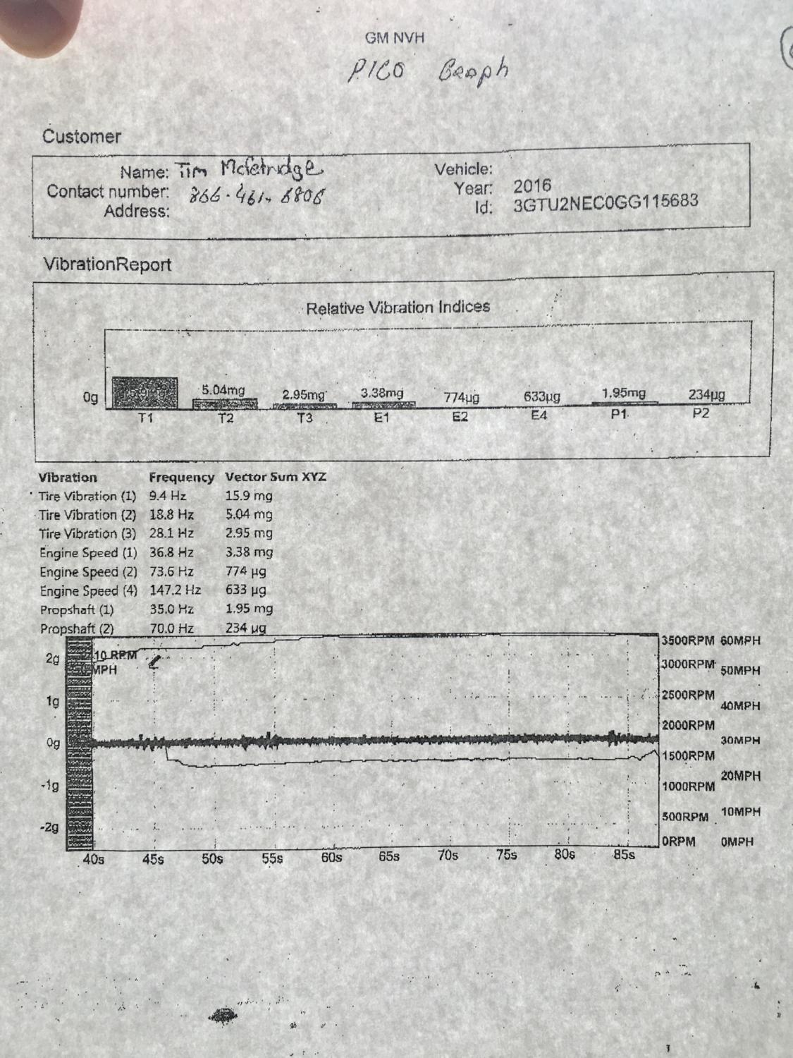

Can someone help me make sense of this? The service manger does not know how to read it either do I. Pico picture attached. Lemon law lawyer has offered settlement from GM but that is based on them thinking the truck is within spec I was told it failed the pico then they sent this and said it didn't.
based upon that, your truck is within GM's made up spec of 22mg. Your largest vibration is a T1, which is something on the truck that rotates at driving speed, ie tires, rims, rotors etc. You will still feel the vibration with a pico scope reading in the teens, mine was 25 reduced to 16, then it went back up, and is currently low. but they didnt give me the reading. I still have a very very slight vibration, enough that I notice it. I would still argue with GM about it saying that any vibration is unacceptable. Be aware. that reading is only a 30s snapshot of the entire drive. they don't give the reading for the entire drive, so we could also possibly argue that we have no way to prove that those readings are truely the worst.
Do you have a vibration issue above 70 mph? If so the pico results don't show them testing the truck at that speed. It looks like you have an All Terrain presumably with 275/55R20 tires. If that's the case a T1 vibration at 70 mph should occur at 12.3 Hz T2 at 24.6 Hz and T3 at 36.9 Hz. 9.4 Hz as shown on the paper work occurs at about 53.5 MPH. So of course it's within spec at 70 mph when data was taken at 53 mph. it's like dropping your phone from 4 feet and it not breaking and then claiming it won't break if you drop it from 8 feet. Service manager can't read a PICO???? But it's within spec, what a load!
