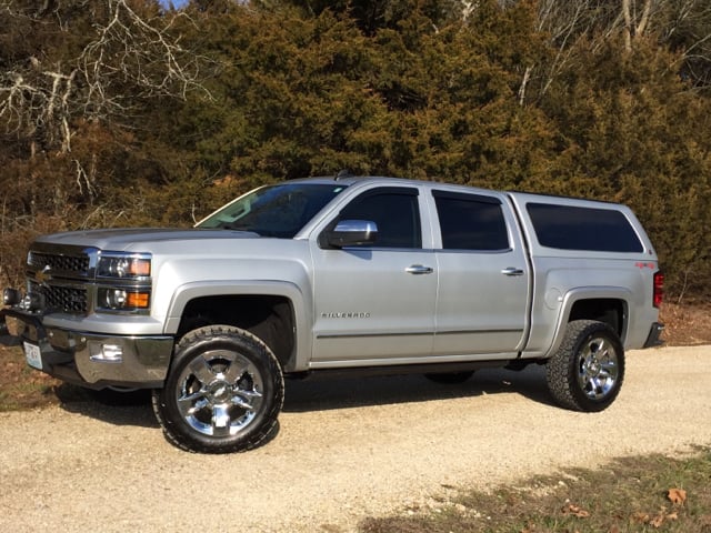

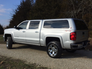

2 inch zone level and 1 and a half zone body lift. rims are 20x10 -24mm tires are 305 55 20
it rides great and sits nice and level
that looks badass.
your truck looks almost nose high with just a 2" level
my truck still has a half inch of rake with a 2.5" level. Is the photo lying or does your truck really sit nose high? either way looks great.
Looks like he has the original wheels and tires in the bed so that might be enough to lower it in the rear a bit and make it lower in the rear in that pic.

I don't leave the camper shell on year around but don't have any yet of it with level and body lift without camper shell.
it is not nose high i guess the wheels and tire weighted it down plus where i took that picture there is decline. and thank you i love the way it looks as well. I planning on ordering a set of super spring. they are basically helper spring to help keep from getting the over loaded look.
