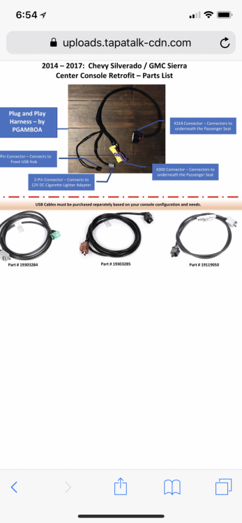

Hey Phil. I have a 2017 Silverado with the jumpseat and want to convert it to the full center console if I can find one. I was wondering if you still had the wiring harnesses. I’m in the process of trying to find one without having to buy one straight from the dealership. Thanks for your time
Yep. I am taking orders for these while on vacation. PM me to order. I’ve got a healthy backlog of orders to fill when I return. I get back 6/19 and have about a week’s worth of order to fill. If you are not on a time crunch, feel free to PM me when ready.
Thanks!
Ok thank you so much. Where could I find the console? Any sites that might help? And also I know this is going to sound dumb but I’m new to this site, how do I PM you when I’m ready to order one. Thank again for everything

Ok thank you Phil. I saw your YouTube video and you’ve made this swap look easy. If I can just get my hands on one I’ll order the harness from you. Thank you for all your help. I’ll be in touch when I find one. If you can tell me how to PM you I will. Sorry I’m new to this site and don’t know how. Thanks a bunch

Got my new console in yesterday and installed this morning.  Now to just send Phil my harness to get everything else working

On 12/13/2017 at 11:12 PM, pgamboa said:
What this comes down to is:
  • My Plug and Play Harness
  • (2) USB Cables - based on the console year your purchased
Thanks guys!  I'll be filling orders on my waitlist, then everyone else on a first come, first serve basis.
How can I order this?
Send me a PM. I need to fully understand your upgrade path.
