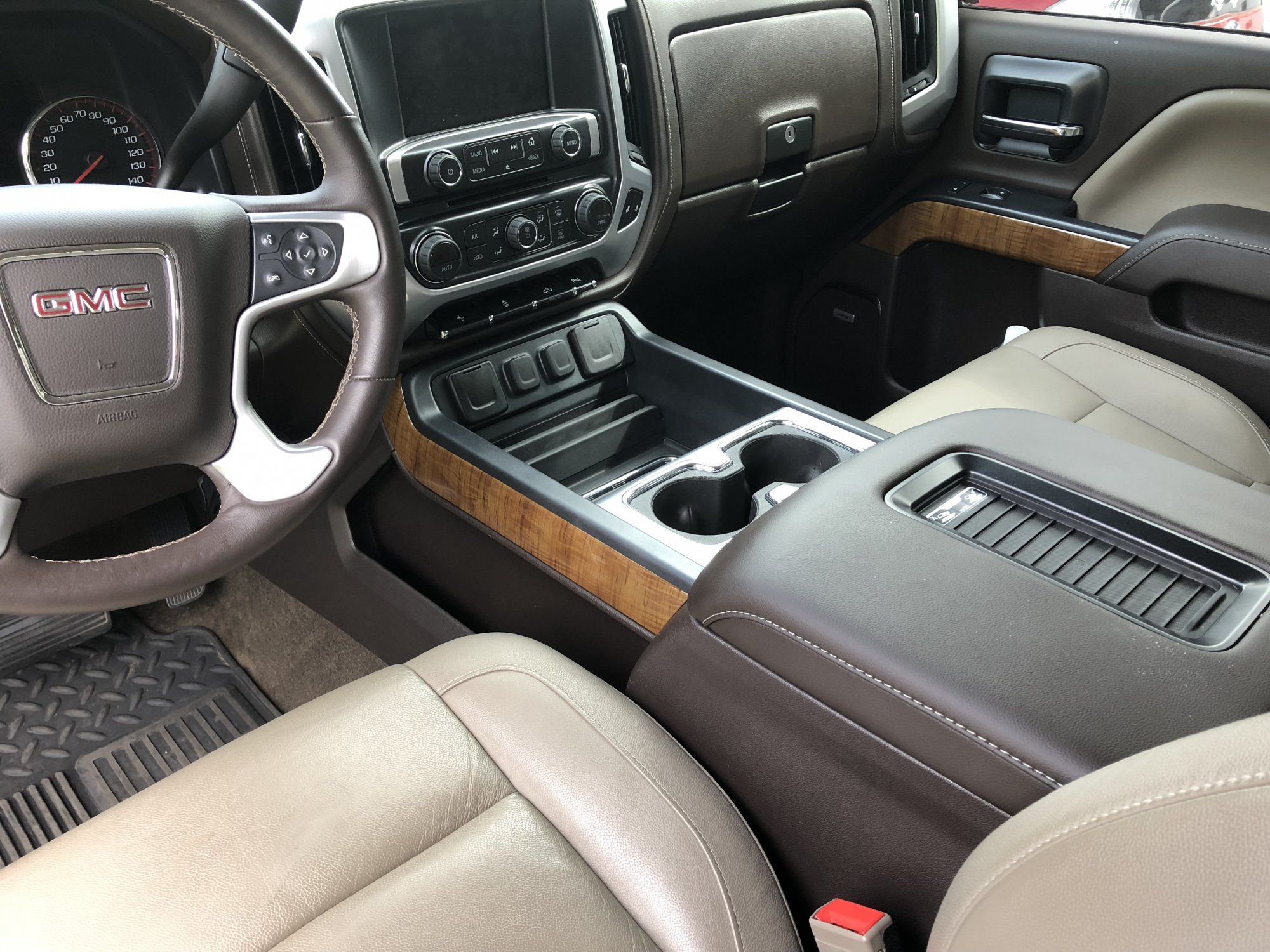

On ‎9‎/‎3‎/‎2018 at 12:34 PM, Baldhills said:
Finished my install.  All is working except the glove box USB.
I didn’t have any open USB’s on my HMI.
2018 parts, so my iPhone 8 and wife’s X are wireless charging.
Have my upgraded HMI on the way to get Apple car play and other later model features.
Thanks for your help Phil!
Looks killer! Is it black with white stiching? If so do you have the part number you ordered? Thanks!!
It’s Cocoa with Mineral Castor wood trim.
If you talk to Corbin at GMPartsNow and tell him what you want. He found all the parts for me.
Tell him that you want 2018 parts to get the latest wireless charging lid.  Also tell him you’re working with this forum and will have the conversion harness from Phil.
10-4 Thanks!!!
I think Corbin needs to send me some goodies [emoji12]
