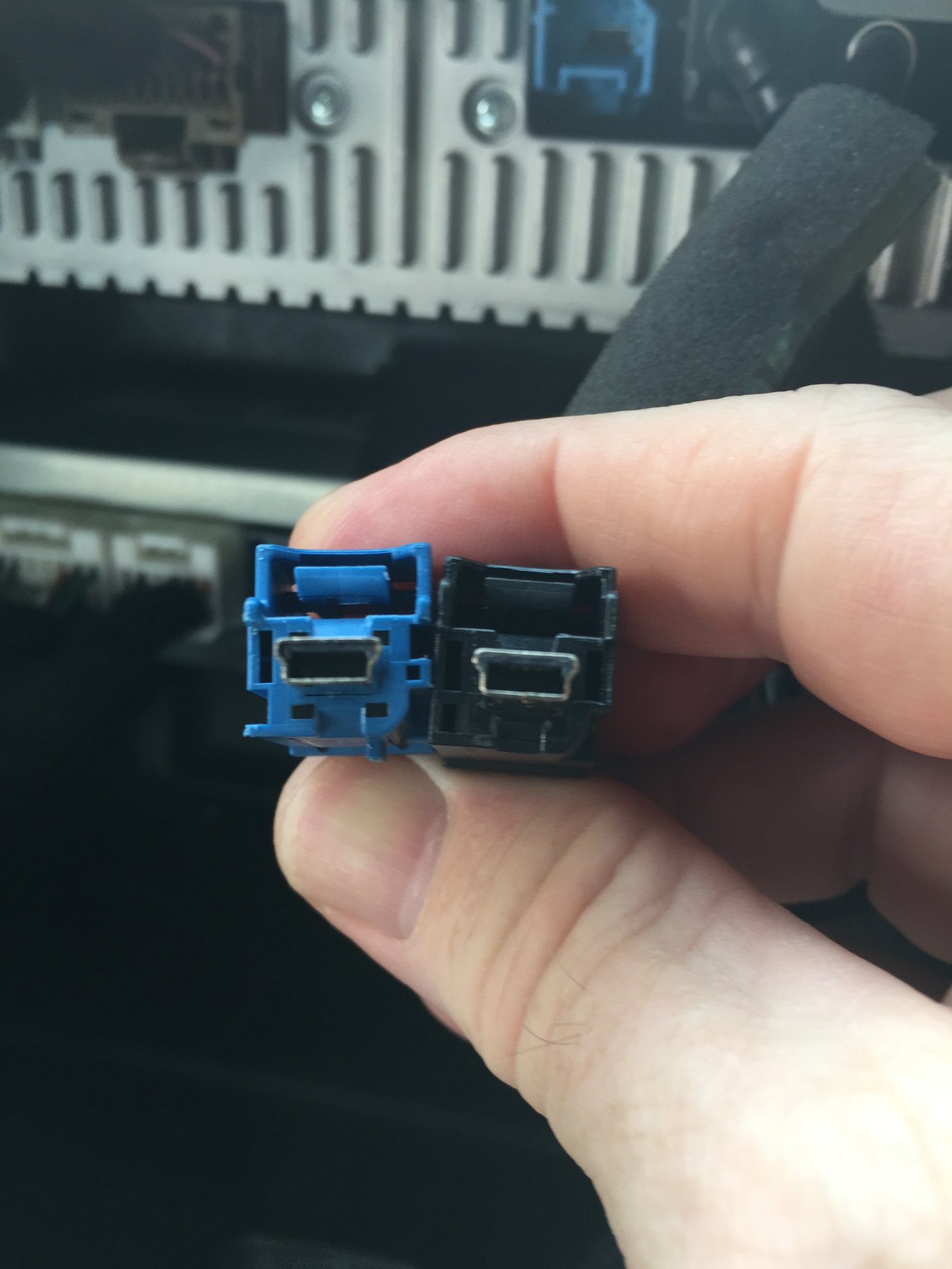

**** NOTE--For my fellow Work Truck owners ONLY !!!*****
Since your truck does not have an HMI you have to get creative. The BLACK end of cable 19119050 has to be modified to fit the BLUE USB behind the radio. This is easily done in about 5 minutes with a Dremel tool once you realize you can finish the job instead of sending the cable back and searching out the correct cable that may or may not exist.
The BLUE connector on the left in the picture below is what feeds the original jump seat USB hub. It plugs in to the module behind the radio and the other end of it terminates under the passenger seat, next to the 16 or 23 pin connector Phil's harness plugs in to. I modified the BLACK connector on the right (really less than 5 minutes with the Dremel) and it is now plugged in to the BLUE port behind the radio with the GREY end plugged in to the input of the USB hub in the front of the console.
The 2 front USB hubs in my console are fully functional including CARPLAY. The two USB hubs inside the console only work for charging. All of the other power ports, 110 outlet, and LED light in the console work as they should.
