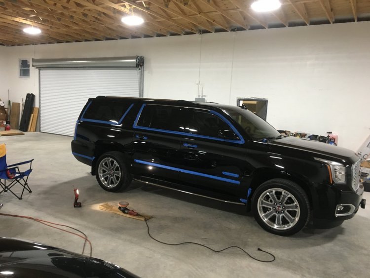

Yes, of course. I just meant for attacking one scratch.  If I gave you a list of my prep and each step prior to polish you would think I am nuts. Powerwash, wash, degrease, inspect again, lights, then clay, then wash again. Totally dry, inspect, feel, test least aggressive polish (softness of paint) then start the step down to jeweling it in(usually 3 steps and pads).Then seal it up. On my Yukon XL top to bottom for pure perfection took three days including every inch in and out. But I am getting older and also take my time. Shoulders ain't what they used to be!!!!

I never thought to use painters tape on things you don’t want wax on great idea. What would you use to get wax off some of the plastic trim? I watched a video of a guy with a toothbrush for about 10 mins lol anything easier.
I use the painters tape to prevent the orbital from touching the trim and chrome mostly when I am polishing. It and keeps the compound off and out of the nooks and crannies too. I use clear glycerine type waxes and sealants never white. There are specific products that get wax residue off easily, I would give Autogeek a call.  Good luck
