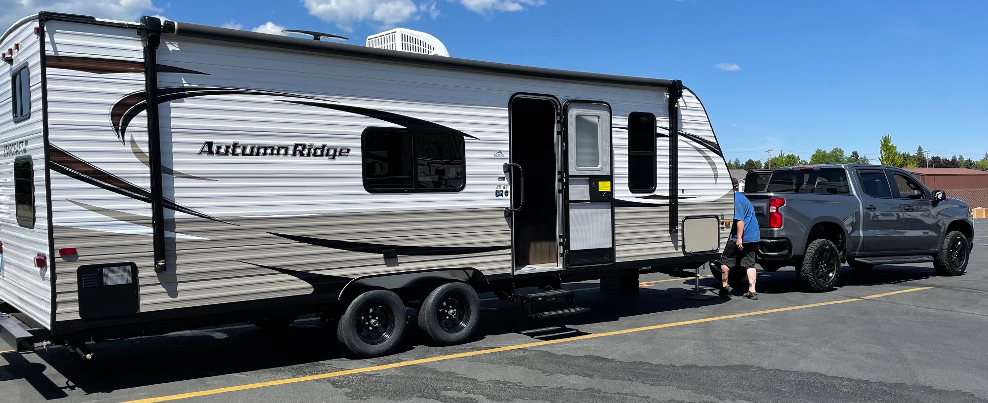

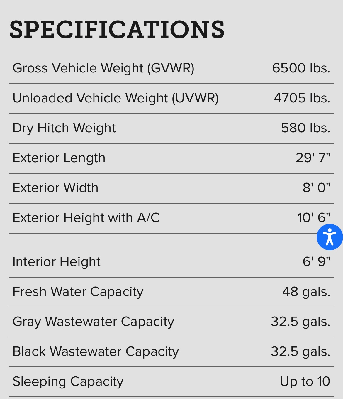

In my opinion you’ll be fine. I have the 5.3L 6spd Custom Tail Boss and it pulled our trailer without any issues. Granted we took it camping the first time this Memorial Day weekend and only went an hour and a half away. Our trailer is a 2021 Starcraft Autumn Ridge that has a GVWR of 6500lbs. It went up hills with barely any struggles. I would recommend looking into a Weight Distribution Hitch, it makes a huge difference. I could be wrong but I think your trailer might be light enough where it doesn’t need one but I think it’s close to the cut off limit. What you’re looking into getting your truck will be more than enough to handle it. Here is a screenshot of the specs. I’ll post a pic of the truck and trailer once I get home so I can edit the size of the pic.
Edited by GreatWhiteMexican
Added pics
