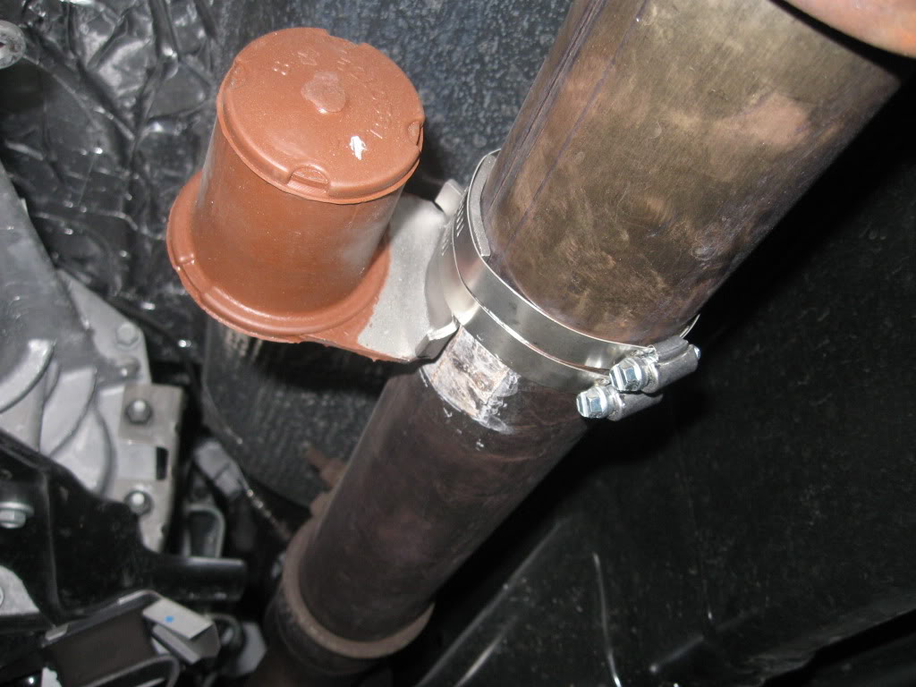

As for the "exhaust pipe weights", what exactly are those? Perhaps they help alleviate exhaust system vibration?
They are dampers and lessen vibration due to exhaust resonance. Many automotive manufactures use them. BMW, Lexus, Ford, this picture is an obsolete version that Chrysler used. The intent is to add weight, therefore damping the vibration and/or vibrating the damper instead of the floorboard.
