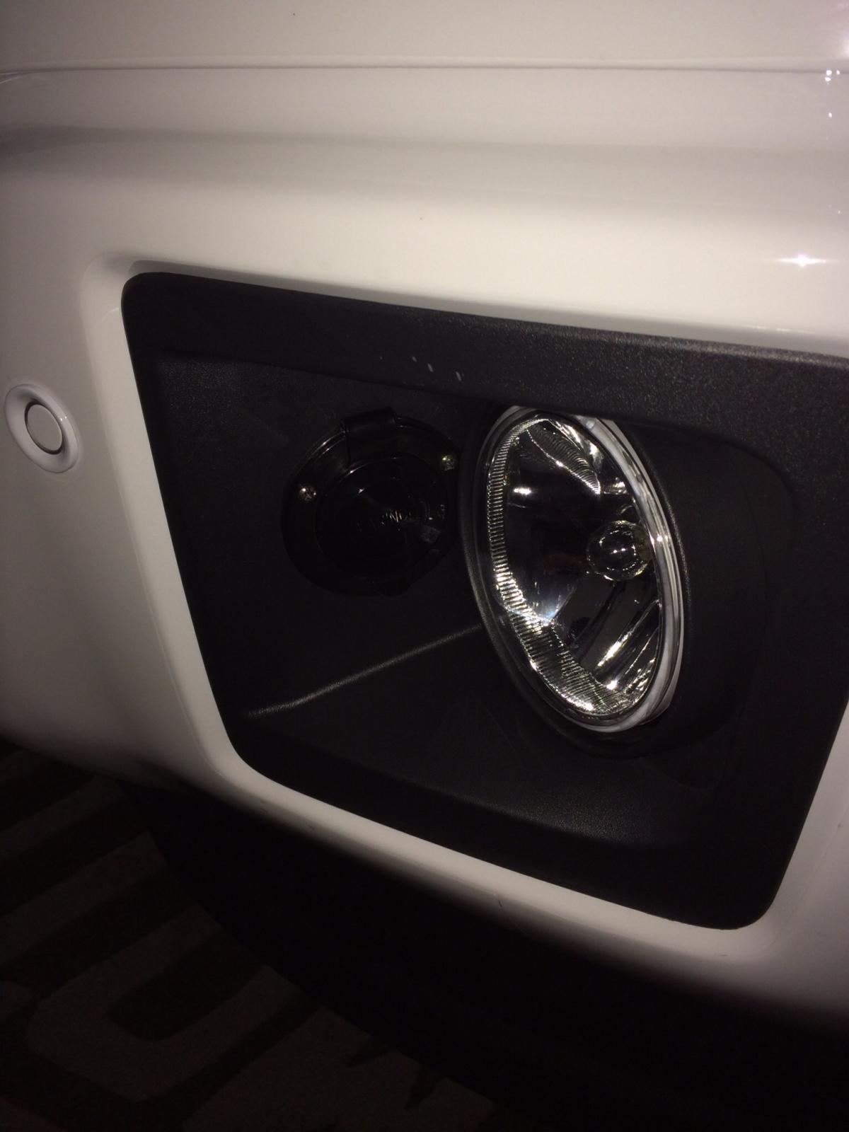

Last night I completed my engine block heater install by installing a 110 vlt marine grade power socket plug in the front left fog light housing as I didn't want to have its cord hanging out of the hood and dangling about. I think this is a "clean" install that will work out well. While I was at it, also installed the same (plug) on my Land Rover which as well is being shipped to Alaska.
Neat job. I wondered what to do about the block heater cord. I don't care to have it dangle out of the hood either. I have the block heater but where did you get the other parts for this?
I used a marine grade 110vlt plug adapter. They are available on Amazon, and from various manufacturers such as Marinco

nice truck, love the block heater install! I was told that you cannot run the front splash guards with the AMP running boards, does anyone have them?
