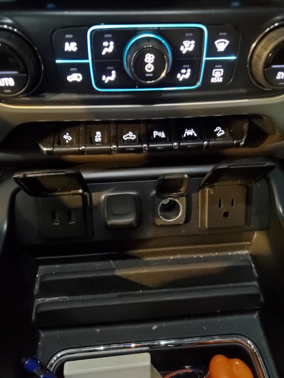

I'm looking to add a dual USB port to the back of my 2017 GMC Sierra 1500 Z71 Crew Cab I have the full console see attached photos of front, 4 ports, 1 dual USB, 2 cigar ports, 1-12 volt plug. Inside the consol I have one cigar port, 1 dual USB port. Back of the consol is one cigar port. 20200104_224846.thumb.jpg.c7c62a175228e31173d35a2bdc36fdad.jpg
I have also thought about this. This would be so much more useful. My brother has an 18 F150 and his truck has the usb plugs in the back and they are much more convenient. Since it would just need power and not data lines, it seems like this would be an easy thing to do, but I haven’t seen the connections on the back of each of them. Phil?

Instead of going through a big mod for this why not just use the cigarette lighter plug on the back of the console and add a dual USB charger plug or remove the factory plug completely and replace it with a 2 port receptacle?

The factory GM USB Hub needs power and a USB data cable to fully power the hub. Best bet is a 12V outlet with USB ports like suggested. That’s what I use.
I've given the latter of using the aftermarket USB unit a thought from the get go i even thought of using the aftermarket port on a hollowed out dual GM-USB port with the factory snap cover. When I install my back heated seat pads shortly I'm going to dig into it and will post back here.
