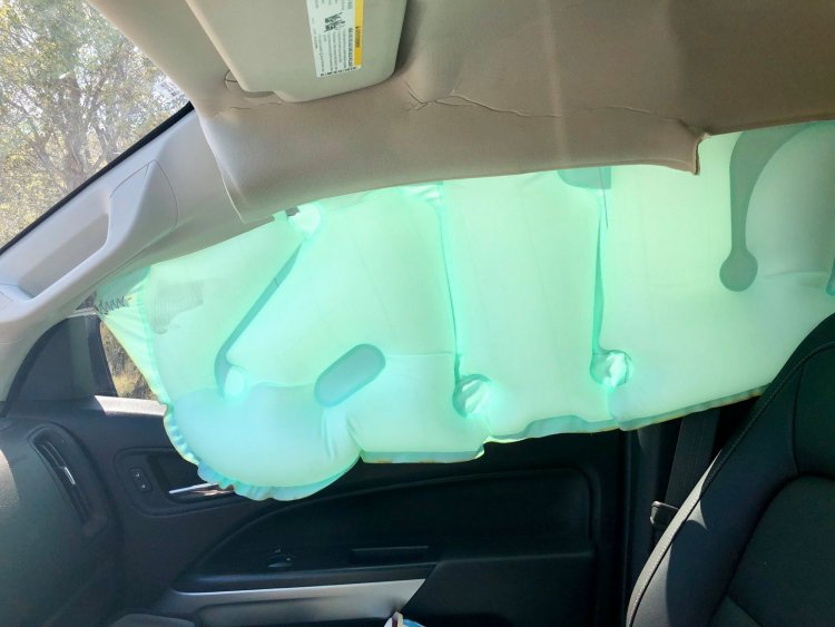

A Colorado ZR2 owner, Joe F., at the Facebook Colorado ZR2 Club has reported a disturbing airbag deployment that occurred during some relatively benign soft-roading. If you’d like to jump directly to the club’s page you can do so here. Joe’s truck was just under a month old when this occurred. He had not modified the truck in any unusual way. He had added a winch and LED lights. Other than that his truck was bone stock.

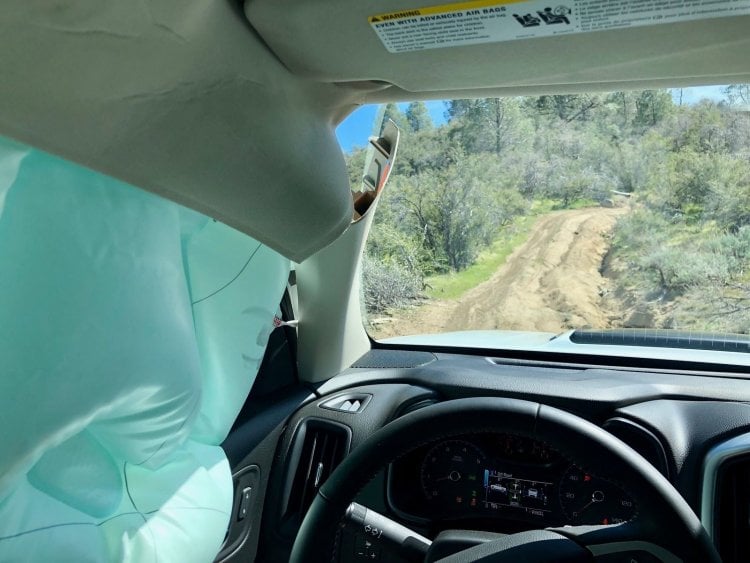

Joe says that just prior to the side curtain airbag deployment, “I was moving up a hill slowly in 4WD LOW with OFFROAD MODE on, passenger side wheel in a rut which had me leaning to the right. It certainly wasn’t leaned over too much. Going maybe 3 mph.” Joe’s image above shows the road that he was on. Joe says the event  “…was quite a violent deployment (explosion).” He was not injured, and the truck was able to run after the event.

Joe has provided a long version of the events that took place after the improper deployment. He has had difficulties with GM. Neither the dealer nor GM wants to handle fixing the truck, which has an estimated repair cost of $6,500. Since the circular firing squad is only just now being put together, we will hold off on saying GM won’t take responsibility at the end of the debacle. You can read Joe’s full overview of the situation to date at the link above for all the gory details on his struggles to get help. If Joe posts a final outcome story we will update this post, or add another.

Ongoing? A few cases each year extremely sporadic isn't ongoing, especially when all manufacturers have had this issue (Jeep, Toyota, Fords/Raptor). Many of times the point at which they exploded are in a much worse angle than the posters lead on (just like this guy saying not leaned over "too much" makes it sound worse than it was and that the sensors deem safe). This guy hit a big dip at 3 mph, 3 mph off road over terrain like that is pretty significant and can put it on 3 wheels quickly. At that point the sensors have to decide (based on parameters set that we can't see to know if we are exceeding) if a roll over is close enough on the info they have. I'd side with the manufacturer most of the time as more often than not they exceed the sensors parameters which as with any failure is not designed to be exceeded.

The yaw sensor saw something it didn't like, but if it wasn't a severe angle like he says, then its possibly an overly sensitive system.  My guess, is the angle/dip was bigger than he is suggesting.  There was some folks doing autocrossing that have run into this.

Most of the comments here are fair enough, if the yaw sensor felt too much a learn then the airbags deployed as intended.
Where does it say in the manual the degree angle you shouldn't pass, using the built in off road angle display that's on the DIC?
It doesn't.
The things that I want to point out is that Chevy markets this truck and a "purpose built premium off road truck" and markets it with photos of it jumping, sliding, rock crawling, etc.   While the sensors or programming in this truck might be perfect for all other GM trucks, this one is supposed to be special - they pretty much dare you to push the limits of the ZR2 in the marketing.  I did just that.
With that said, my first gripe is how the engineering on this truck and marketing are two far different things if the airbags can go off (even on just a small number of them) when it's not in an actual rollover situation.
When I said "not leaned over too far" I mean that there was absolutely no chance of the truck rolling over and I felt I had before been on angles steeper than when it went off.  I know, it's subjective.  I was moving slowly, in 4wd low in offload mode, there was not sudden drop or jolt.
