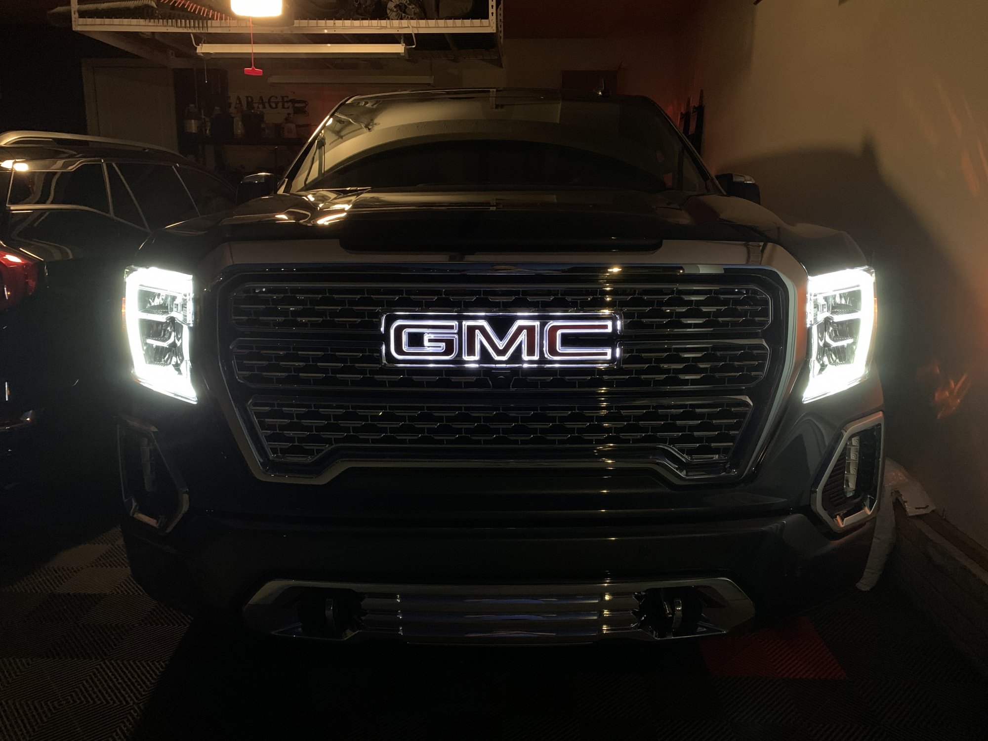

I installed the OEM black GMC letters on my AT4 this weekend and thought I would pass this shortcut along.  If you don't mind being a bit destructive and want to take the easy route - just pry the red insert off of the factory emblems and it exposes the retaining clips.  Insert a screw driver and they pop right off.  No grill removal required.  I had one or two tangs that didn't immediately snap back in on the new emblems.  apply a bit of pressure to the grill tab with either your finger or a flat blade screw driver from behind until it clicks.  You are good to go.
Firstly, Thank you for this, you saved me a lot of time.  But I have a small request  -Can you better explain the best way to clip them back in?  The G sounded like it clipped in, the M didn't sound like it, but seems to be OK, and the C can slide in and slide out (It's not clipping in).  Where are you applying pressure to clip them in...from under the hood with the hood popped?  A huge storm is about to hit my area, and I can't fit in front of the truck with the garage door shut to try to finagle this to clip in, at the moment.  Hope to get a response so I can clip it in first thing tomorrow morning.   I appreciate your help.

Very unlikely you’ll get them out without breaking them.
You can actually get the front emblems out if you just remove the air intake tray and reach your fingers through the active air flow vents.  you can also unclip a vent or two if you need to.
