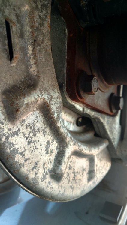

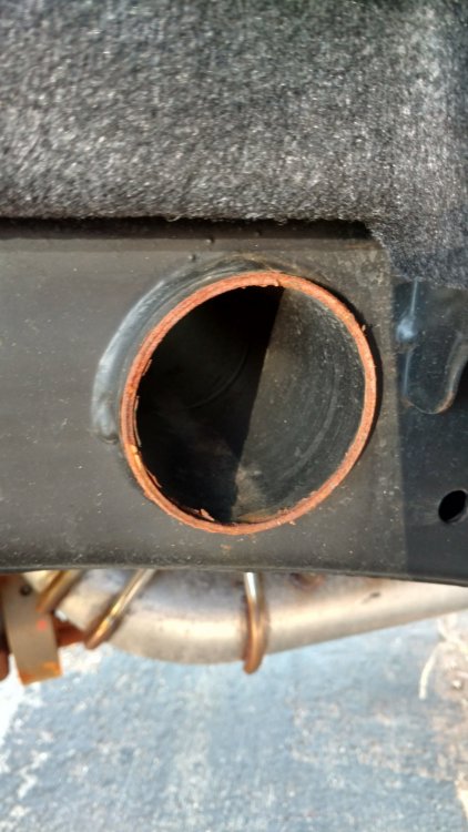

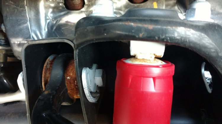

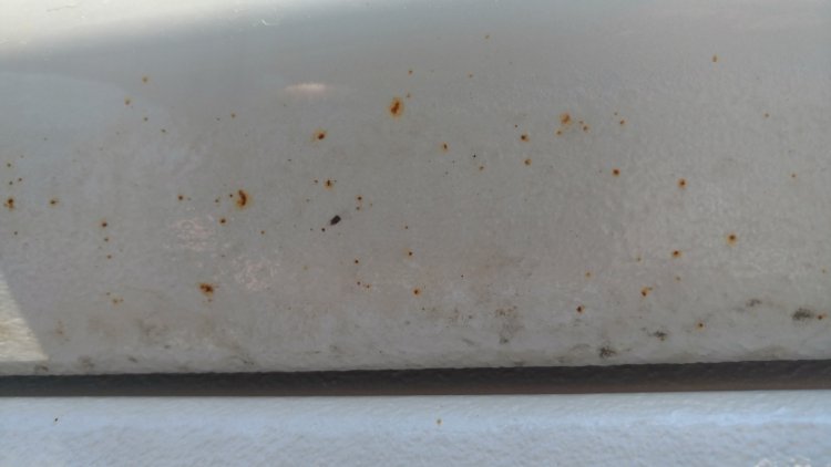

I purchased a brand new 2019 2500HD LTZ Iridescent Pearl,  2 weeks ago here in Oklahoma. The truck had 26 miles on the odometer. 3 days after I brought it  home, I gave it its first washing. I was so proud of this brand new truck until I ran into rust, on the lower part of the doors. I thought to myself I just purchased a brand new truck for $60,000, why in the world am I seeing rust. I immediately crawled under the truck to find multiple components that have significant/moderate red rust showing. The trans pan and rear disc brake covers are losing their plating with rust coming through.
I immediately contacted the salesman asking to bring the truck back and trade for a different one, but......I was told financing already went through and they could not take it back. That was 3 days of ownership. It's been very painful and disappointing to this point, but I did get the truck into the Service Manager and he took pics and trying to see what GM is willing to do. I just came back to Chevrolet after years of Purchasing Ford products. I even have my 1949 5 Window that I drove in college.
Has anybody seen this before on brand new GM trucks? See Pics
The “rust” on the paint is raildust. A good clay bar application, polish, and coating on the surface will fix that.

It is very sad that other manufacturers take precautions to limit/prevent rail dust when they transport via railroad, yet GM has not done this.

How so??? You can get rail dust after transport doesn’t just apply to that .
My 2010 and wife’s toyota van would get it in the winter, most likely from salt / snow plowing. Doesn’t t take much need to clay polish and protect repeat over time.

That's rail dust? Looks imbedded into the paint to me, I dunno.
Some how i was getting this regularly awhile back. Wd-40 makes it wipe right off.

In all seriousness it isn't a GM thing, it is a common unfinished issue between all brands from rusty parts that aren't coated and don't need to be to rail dust that hits every car and manufacturer that is sent on a rail and not wrapped in plastic. The paint the dealer should take care of for you or you can simple enough. The other stuff under the truck will cause no issues for a very long time, it is hidden and if it bothers you throw a coat of paint on it. Go look at any truck at particular parts that are uncoated and you will see the same thing. Coming in here whining about something if you had searched would have seen is a common non-issue and talking about returning the truck isn't a good first impression...
