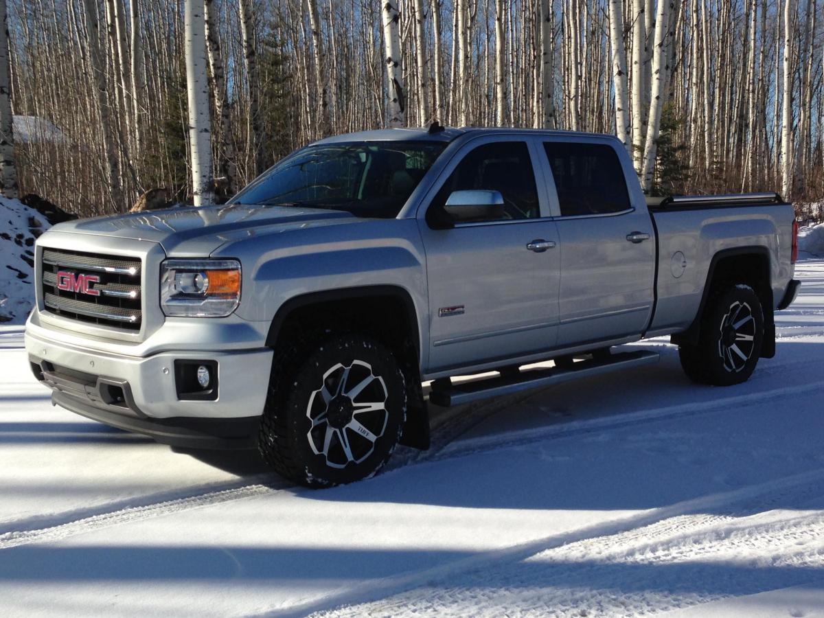

I can't believe all the problems you guys are having. I bought the very first truck off the carrier and the only thing that I didn't like was the poor headlights, so I switched to HID's. I live in northern Alberta and most of this winter has been -30C and I haven't plugged the block heater in until it hit -40C, starts great every time.The first trip we took was thru two mountain passes and was 3,500KM and my fuel average was 10.5L per 100KM. The dealership had to beg me to bring it in to do the recalls. I love my truck and enjoying personalizing it. Lift kit, wheels & tires, box rails, tinted windows (front) etc.
