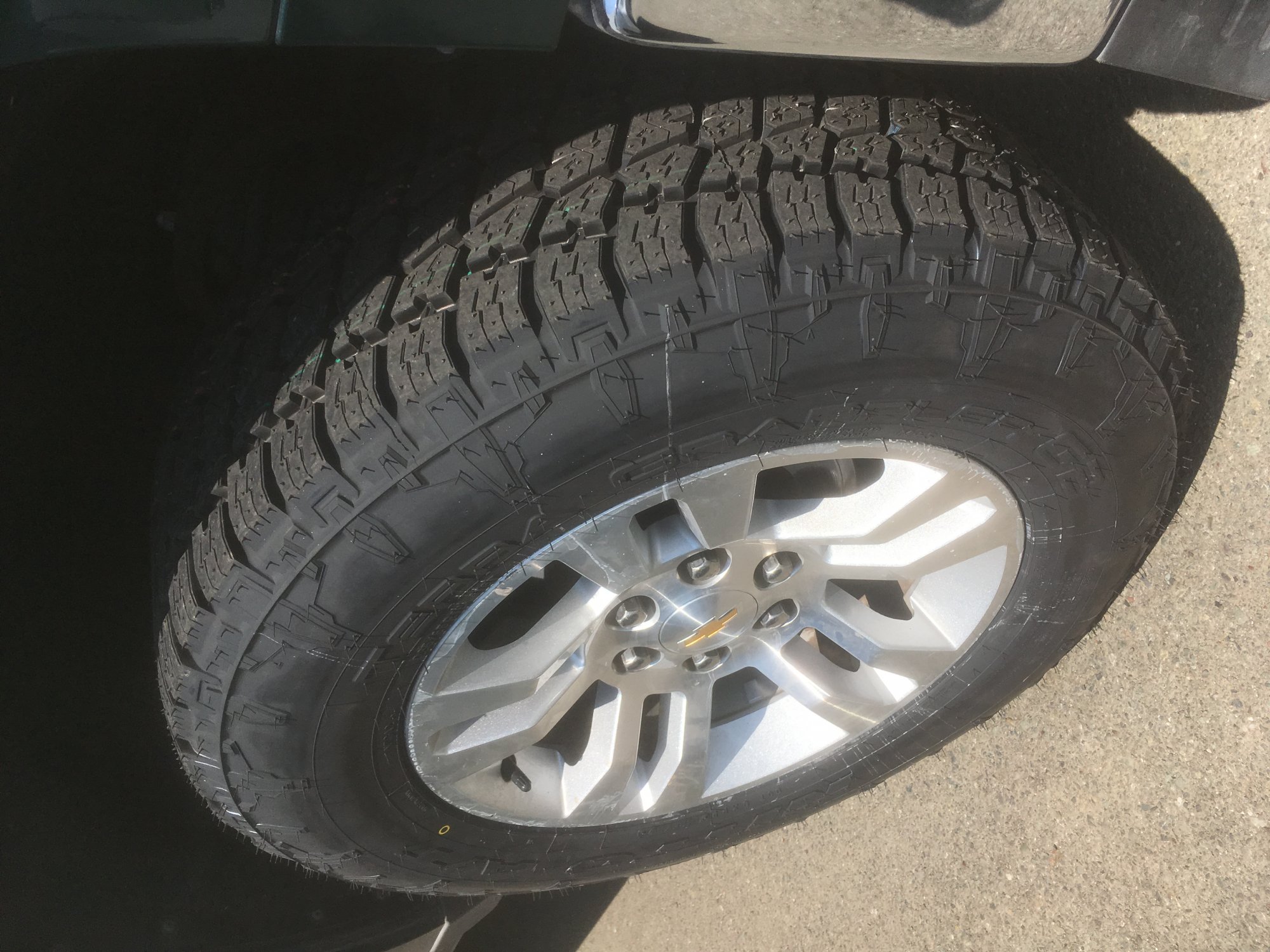

Finally
I have new tires and my truck is smooth as it’s ever been! 47k on odo
cant believe I drove 30k with the truck like it  was.  Guess I had terrible luck with my previous tires.
The SrA-s begAn the shake.
then I bought Mikey Thompson’s and it was no better.
im very impressed with these Nitto G2 all-terrains. Super soft comfort tire. Well see how long they last shake free.
ill follow up with road-trip results.
As suspected one must have hi-quality tire or these trucks will shake very bad even when the wheel balancer says it’s fine.
i bought from the dealer In case  I had to keep trying for another set.
I think I can even feel the drive-shaft working now ,lol
Finally it feels like I’m driving the Chevrolet I wanted!
