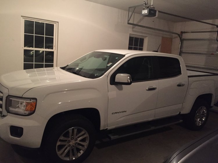

just to  add, I dropped off the truck this afternoon and they gave me a 2019 Canyon. Night and day difference in driving that than my 2018 truck. Mechanic said to "be patient" then later clarified that they had a couple of Sierra's in for the transmission issue. We'll see what happens. I did ask about about the F150 on the lot :lol:
