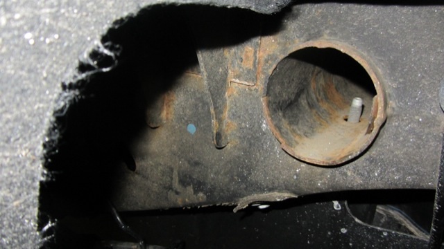

Anyone else with a new 2014 Sierra having an issue with the frame rusting and paint/wax flaking off? I have 3000 kms and it looks horrible. I also own a 2011 Canyon service truck with 105kms and the frame looks like new. So irriating as my Sierra is a beautiful truck aside
Ya talk about frustrating, I just cleaned the snow off mine this morning and I noticed there's all surface rust spots along the front bumper. Not very pleased at all, the trucks only 6 months old.

I have surface rust on my frame also. Alot of salt on the roads this winter in Ohio. I always spray underneath as often as I can .
There is a TSB out on this, GM had some problems with the wax coating on a small run of trucks. Take it into the dealer as the TSB gives direction on how they are to repair it.
Any idea on what the tsb fix is? I know on earliar silverado models I have seen frame rust on trucks that are unsold sitting in the dealers lots.
I remember that when I had my truck on a lift, frame coating in contact areas with lift rubber pads came off and stuck to the pads. I just recoated the bare spots with rubberized undercoating. If the spots are small and there is rust present, you can just brush it with wire brush and spray on some undercoating.

Count me in for the rust! I've been playing with the air pressure in my tires to see if it makes a difference in the ride and vibration that I feel, and I was letting air out of the left rear tire and noticed my undercoating cracking and peeling with rust under it. Look under the truck and found more under the area of the rear door. I have spots of rust hear and there all over the frame and that's probably somewhat normal, more of a bleed through and my deaIer had my truck up on a hoist at least 3 times and where the pads touch the frame the wax came off and it's rusting. That suff Is going to happen to all the trucks but it should be peeling and cracking off in non wear areas. Checked the right side and so far it's ok but I bet it's just a matter of time.
I'll try to get some pics up.
