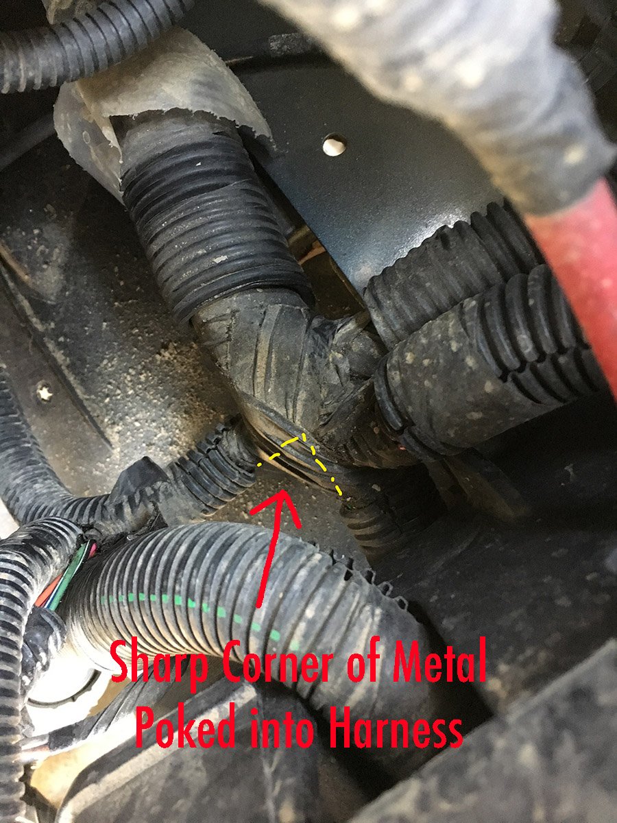

When it failed most recently, I started looking for the problem you describe.  I found that the problem centered around a wiring harness behind the under-hood fusebox (toward the driver compartment).  When I pushed down on the harness, the turn signal stopped working.  When I lifted up on the harness, the turn signal started working.
I felt under the harness and detected a sharp metal corner poking into the harness.
It is a difficult to access area.  My solution was to wrap that area of the harness in leather and fasten it on with tie-wraps.  Now, the metal corner cannot invade the harness.
Now, my turn signal works all the time.  I can press down or lift on the harness and it continues to work.
Oops.  I got the orientation of the picture incorrect.
Here is a corrected picture.
