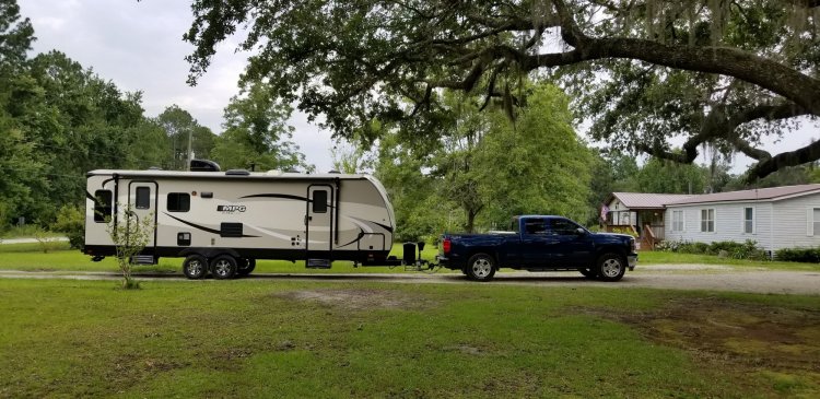

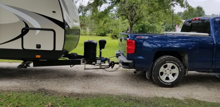

Here's a couple pictures of the setup taken when I got home.
To me it looks like the trailer is leaning forward a little and the truck has a bit of squat, but nothing excessive.
What do you think?
The truck and trailer look as you say they do but the land also seems to slope down a little to the right.
I've had good experience with 1/2 ton trucks and weight distributing hitches. I'm not sure how you're attaching your chains, but an easy way is to hook up the trailer and then jack the trailer and truck up, hook up the chains, then lower everything. You can measure the rear wheel wells with no load and then adjust the chains to where you're at the same height with the trailer attached.
Your trailer is not level. I’m pulling 6500lbs Jayco no issues.
I suspect your shank is to low.
The trailer hitch at level should be at your shank ball height of your truck when disconnected.
Then you bars should level you back out once connected.
I run mine on link 2 at the top of my chains empty and 3 loaded.
The links depends on your shank angle.
You can pull harder on your  bars when loaded.
If the setup is right only one link is ever needed.

I agree.  The guy who set it up did complaint that he'd have preferred to do it back in the shop where the floor is more level than the ground was.  I didn't think it was that bad, but he had the camper practically on the bumpstops it was squatting so low.  I can't imagine that was correct.  I've been doing some light research in to hitches and my current favorites are the equalizer and the strait-line hitches.  We're not looking to buy too soon, so I'll look into that more later.
The driveway isn't level by any means, but the slope is exaggerated by my not leveling the camera.  It's more level than it looks.
The way I attached it was to hitch the trailer and use the tongue jack to raise the trailer & truck together until I could get the chains on it.  I think that's what you're describing.  I was measuring at the front wheel because I figured that's where I was most worried about it.  I figured I wouldn't be able to eliminate all the rear squat, but I wanted to get more weight back on the front.  Should I have measured from the rear?
I agree about the shank height.  As soon as I saw that picture, I thought the same thing.  I'm glad to read that you're using two different chain lengths for your configuration.  It seemed logical to, but they didn't mention anything about it.  Of course, the tech seemed to think the 2 links I asked for was more than necessary.

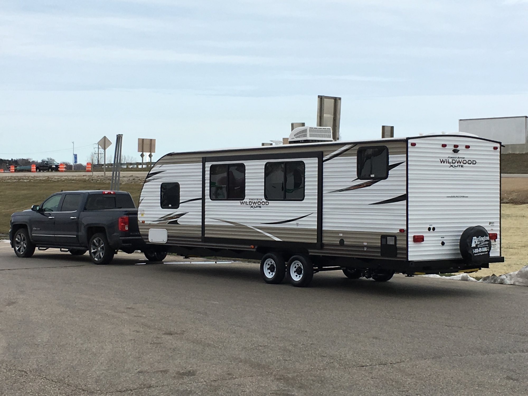

Also agree with the shank height being the main problem. I have an Equalizer with a similar trailer (31.5ft, 5800lbs dry) and setup properly, it barely sags. It pogos a little bit when it's not loaded but when we're at full camp weight with water, firewood and all our gear, it's pretty smooth. The Equalizer is noisy as hell, but it works great.
That's a nice looking truck.  I love those Centennial Edition badges.
You're right, you're almost dead level.  I think next time, I'll forgo their tech hooking it up and rig it all myself.
Do you like the equalizer hitch?  I've wondered about the noise with those friction systems and was kinda leaning towards one of those cam-based jobs.
