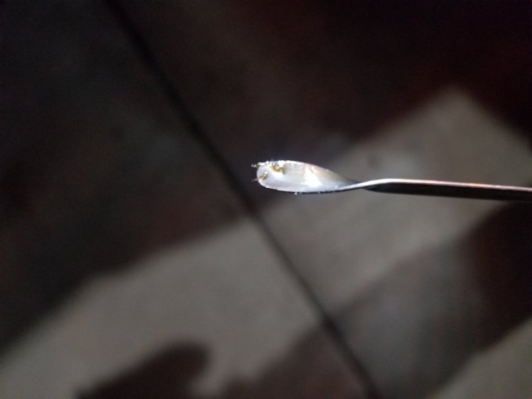

Bought a 2015 Silverado 1500 lt double cab 5.3L V8 4x4 with 12,000 miles on it a couple months ago. It now has just under 20k miles and when I went to check the oil there where metal shavings on the end of the dipstick. Concerningly big metal shavings. I brought it in to my local GM dealer and they told me that it's from the dipstick scraping on the dipstick tube. They didnt run any tests on it they just drained it and looked in the oil itself and didnt find any shavings (so they said). Which sounded a little shady to me so I started looking to see if anyone else had this problem and I found a few cases similar but not enough for me to come to a solid conclusion. The pickup runs great and I dont hear or feel any problems but any insight would be greatly appreciated. I thought about sending a sample to be tested myself but I dont know of any good company's near me that do it. Any recommendations on that would great too. Thanks
Now is that response/explanation from his dealer just from left field or what?
