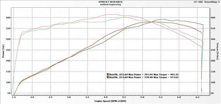

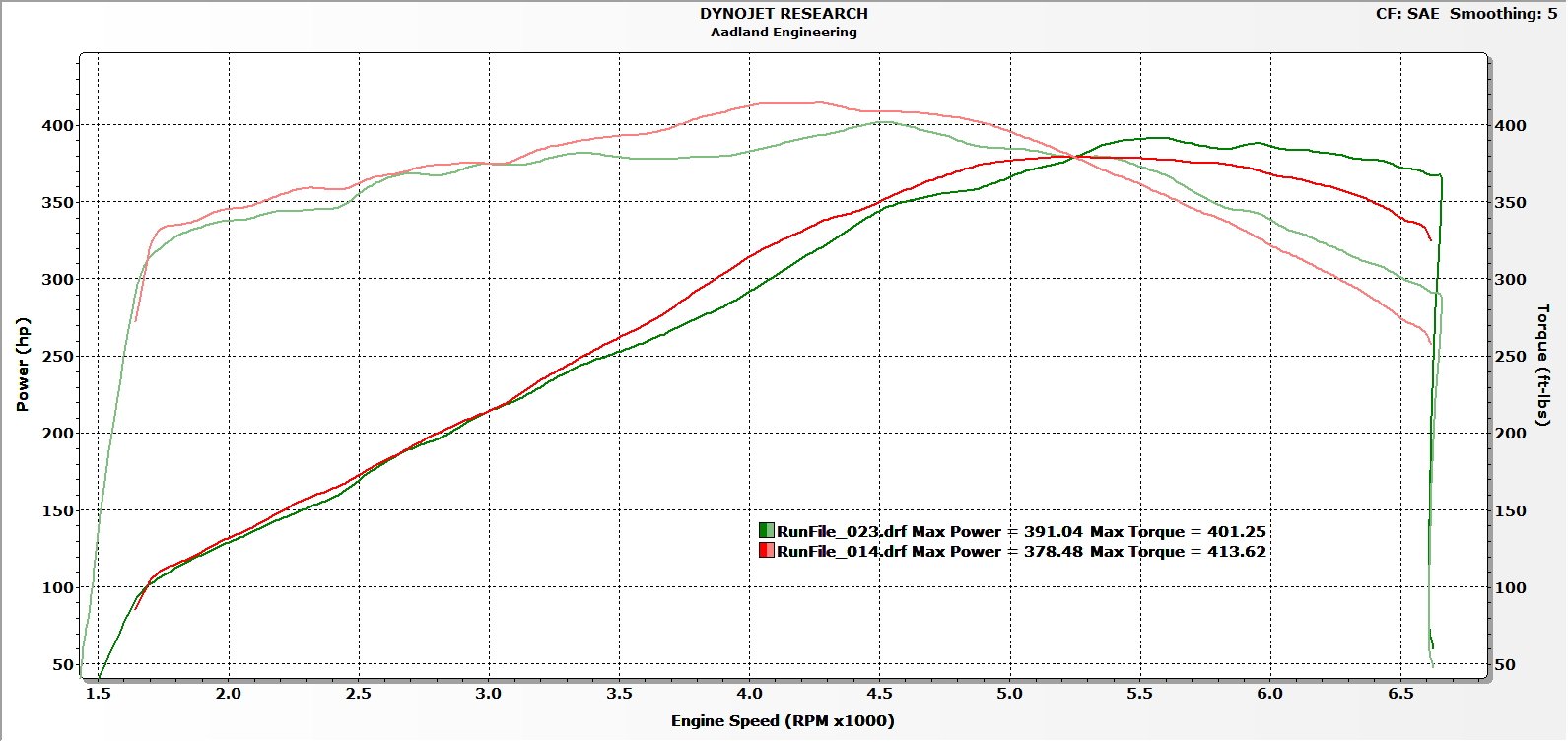

This is JonA's truck and his testing with an unported MSD vs stock L86 on his 14 6.2 6spd in 3rd gear with 91 Oct.
