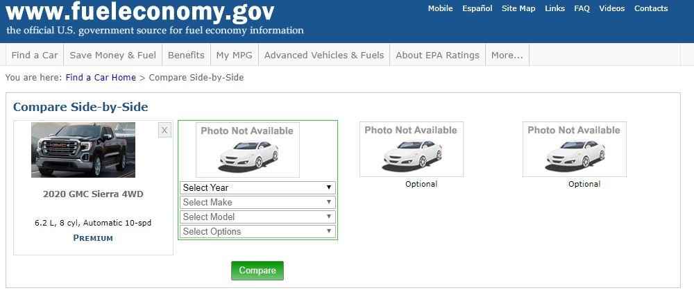

Can someone show me where GM says 91+ is required for the 6.2 ?
Recommended ? yes, if your in 100 degree doing back to back pulls , or your pulling a 8k+ trailer . but just dont see the need for higher octane for cool weather or basic street/highway driving.
This is not an insult to anyone who does use 91+ , just my personal observations .
It's on fueleconomy.gov
I noticed it when I was researching trucks. They're most likely getting their information from the manufacturers, unless they made an error it clearly reads Premium.
I'm sure that using 87 Octane in the 6.2 is fine. We have a car in the household that recommends 91 octane, been running 87 since we got it in 2012 and its totally fine.
If the manufacturer recommends it, then there is a reason why. I'm no expert, but its probably going to result in slightly better performance. Why else would they recommend it?
 It is NOT required as people seem to think. It's recommended (as your image shows) to achieve maximum power and fuel economy but runs just fine with regular (for those that say premium is required, read the text note. Says "fuel down to 87 may be used"). I'll post this extremely in depth ~70 page research paper from AAA conducting testing on multiple vehicles that recommend or require premium to see what the effects are. They actually say that they recommend running regular in the 6.2 because the mpg increase does not offset the fuel cost. They state that power reduction was ~2% or less on their dyno testing and fuel economy was most affected on flat ground. They observed 0 pinging or knock issues on regular because the ECU was able to switch to a lower octane table. Everyone saying the 6.2 requires premium is wrong. GM recommends premium. It was likely done to increase mpg number because they get dinged on fleet average mpg. So it's in their interest to tell us to use premium if it increases mpg 1-2 mpg, because their fleet average goes up, even though it's cheaper $/mi to run regular with slightly lower MPG. Their only metric is mpg for fleet average mpg.
There are NO issues with running regular gas in the 6.2, despite what ill-informed people seem to think and say with 0 data or facts. Yes, your mpg will be affected slightly. Yes, your power will be affected slightly. Data shows 0-13% reduction in MPG (depends on driving conditions as shown by my below link), and power is down ~1-2% at > 4k rpm (no change below 4k). If you don't rev your truck much, you don't even lose HP!

13 minutes ago, Jonofmac said:
It is NOT required as people seem to think. It's recommended (as your image shows) to achieve maximum power and fuel economy but runs just fine with regular (for those that say premium is required, read the text note. Says "fuel down to 87 may be used"). I'll post this extremely in depth ~70 page research paper from AAA conducting testing on multiple vehicles that recommend or require premium to see what the effects are. They actually say that they recommend running regular in the 6.2 because the mpg increase does not offset the fuel cost. They state that power reduction was ~2% or less on their dyno testing and fuel economy was most affected on flat ground. They observed 0 pinging or knock issues on regular because the ECU was able to switch to a lower octane table. Everyone saying the 6.2 requires premium is wrong. GM recommends premium. It was likely done to increase mpg number because they get dinged on fleet average mpg. So it's in their interest to tell us to use premium if it increases mpg 1-2 mpg, because their fleet average goes up.
