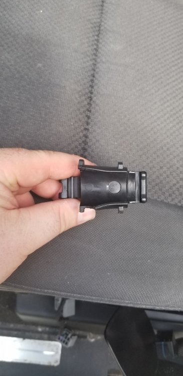

The work order list, Refer Pi1183a, movement between seat pan front pivot points&a pivot bar, lubricate front seat pivot points , install seat actuator shim clip and seat cover retainers,, it fixed My truck

It fixed the front to back rocking. They had to install the clip to get the seat bottom to stop moving independently from the back.
