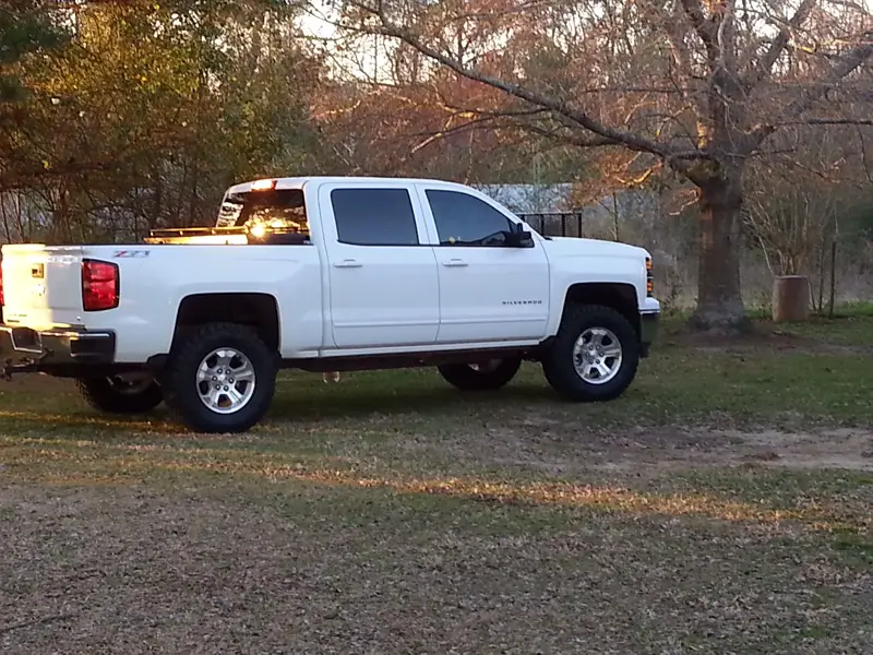

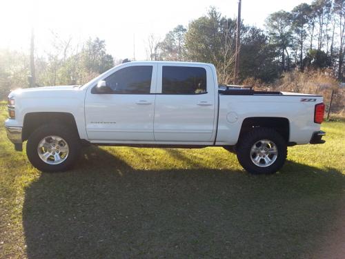

Sorry it took a couple days to get back on. With y'all guys info I ended up going with the trail grappler 295/75 and couldn't be happier. Got them mounted yesterday and as z71 Chevy said there is a little rub at full lock on the sway bar. I went ahead and took a couple pics of my seat covers too. Also, the truck running the 305's I met at the deer processor just passing through. I didn't know him personally, sorry.

nice clean looking truck! perfect height

Do you mean 295/70R18 Nitto Trail Grapplers?
Is it the sidewall of the tire hitting the swaybar, or the knobs of the tread? I'm assuming it's due to the section width of the tire...the "bulge", rather than anything to do with the height, so I wonder if the BL helped you any with that tire size? I think you would have that rub with or without the BL.
Just like Z71-Chevy, you could probably use a small spacer to push out the tire a little and cure the rub...probably a +18 or 0 offset.
The section width of my 275/65 Nittos are 10.98" and when I put a bungee on my steering wheel to hold it locked, I have 3/4" or more clearance between the tire and the swaybar. 295/70s are ~11.75". That's less than an inch total wider, so if you split that in half, I should have 1/4" clearance at the swaybar....but y'all are saying it's rubbing. Makes no sense (mathematically)!!

Perfect height in my opinion.
