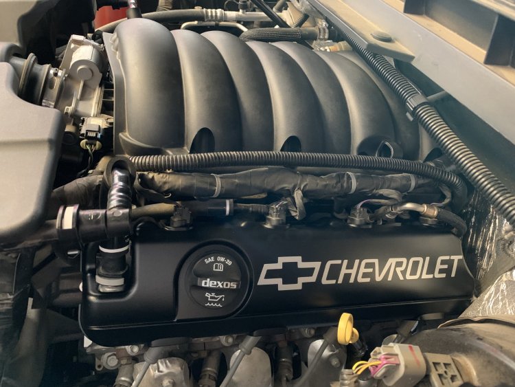

 I just saw this thread and really dig that you guys are interested in this as well! Because when I was building my truck most of my friends were like it’s a truck why the hell are you touching the engine bay nobody cares unless it’s a turbo or supercharger. Haha I know this is not as cool as the the aftermarket covers but I also wanted to add a little something under the hood so that I had just done a little something custom to every part of the truck.  So a little sanding to remove the texture and then just painted to color match and powder coated a couple pieces when I did everything else for the truck. I think it gives the engine bay a little pop (If you’re tall enough to see it lol)  The only change since this picture is I rerouted the overflow hoses underneath the intake instead of on top .

How do you get the intake manifold cover off? I’ve got the coil covers off so I can repaint and decal. Trying to get the manifold cover off now and am having no luck. Removed the bolts, wire harness, three zip ties from the back (firewall area), and still can’t get it out. Any words of advice?
Just finished my coil covers. Applied promoter adhesion since they are plastic, then painted them with VHT matte black. Used my wife’s vinyl cutter and made the decals. Design is from the 454 SS decal.
It is definitely not an easy task to remove. I’ll  answer more in depth in your message you sent me but it takes patience and being able to work well backwards looking at a mirror.
