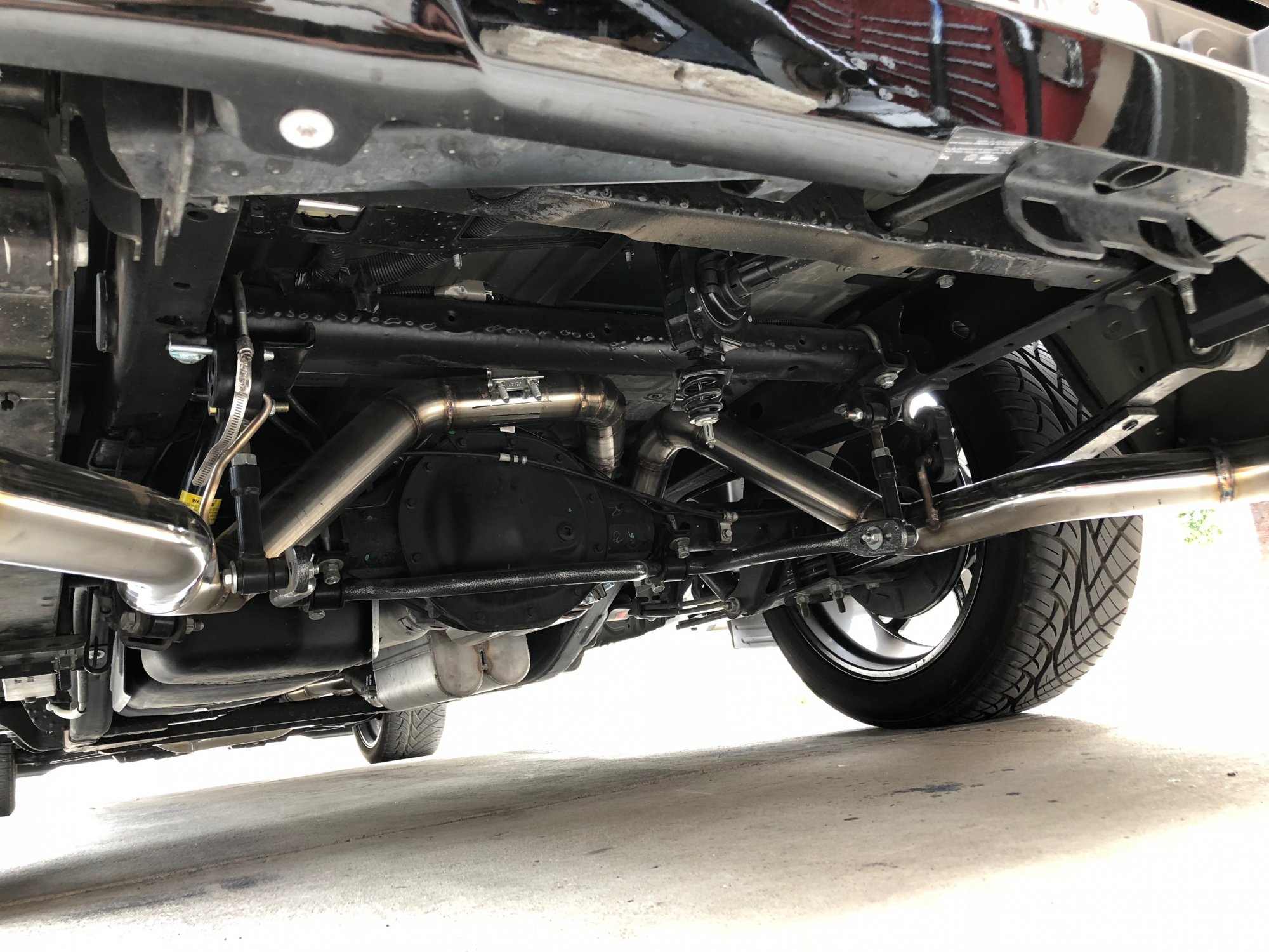

Exhaust pics with cutouts
11433
Hey, I was looking at your thread as I am looking for a roll pan for my 18' Silverado and noticed that you also have a Hellwig rear swaybar. Your links have the spacer in the wrong place, they are supposed to go between the sway and the link. Nice truck BTW.
