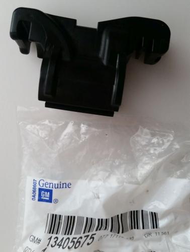

First, acquire the retainer part. I got mine for $5.08 to the door.
For 2014-2015, just pop the retainer on the seat bar and put a zip tie around it like the last picture in the PIT5542 doc posted above (post #910).

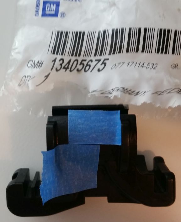

Use some painters tape to outline where you will cut to make the retainer look like the modded one from the GM doc:
You'll see the molded seam mentioned in the doc.
Clamp it lightly into a vice or hold it with vice grips. Either way, be sure that it is stable so you don't F yourself up. I used a towel around a small vice so as not to damage the retainer when clamping it:

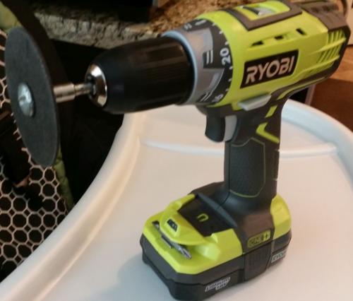

Use a grinder or cutting tool or even a sharp pair of dykes or razor knife (Without cutting yourself. always cut away from your body). I used a small cutter wheel attachment in a drill:

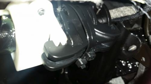

At first, I wasn't sure if I was to cut only one side until I tried to put it on. The "welded" bracket tabs mentioned in the PIT5542 will most contact the rear of the retainer. Cut both sides the same way and trim away the slag.
I had to trim mine back a little bit after the initial cut as the retainer wouldn't sit flush. You'll know what looks right and what doesn't when you go to fit it on. Trim back little by little until it fits nice. Move your seat up or down until the retainer sits even with the white guide block (you'll know it when you see it).
Install a zip tie (I used two since they fit) and trim the tail(s).
