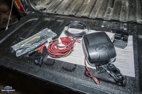

Installing the RideControl and WirelessOne:

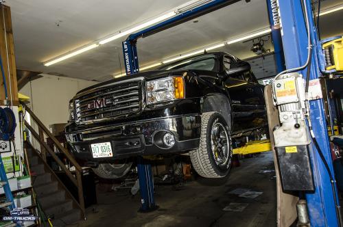

Installing the RideControl is a task that is entirely possible to do in your driveway with a set of ramps or jack stands. With that said, this is not a beginner project and if you’re not entirely comfortable digging into your truck and running wires, we’d suggest having a professional complete the task.
While we won’t go over the entire process, installing the RideControl breaks down into a few easy steps.

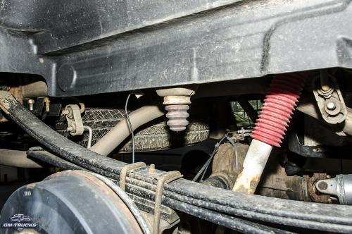

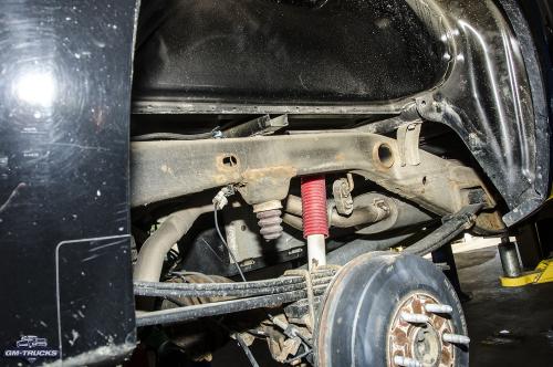

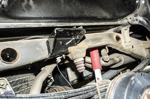

First we removed the rear tires, the rear inner wheel well liners, and the rear spare tire.

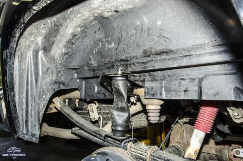

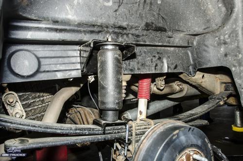

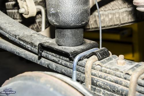

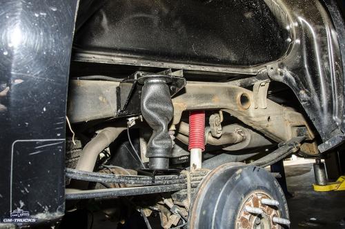

Then we mounted the brackets to the frame and leaf spring along with a deflated airbag. It's worth nothing no drilling of the frame is required.
The next step is to run your airlines. Both bags will be connected to the same compressor. We ran the lines from each airbag to a ‘T’, which in turn had another ‘T’. One end of the hose will be run to the air compressor while the other is tucked behind the rear bumper and equipped with a schrader valve for emergency manual inflation.

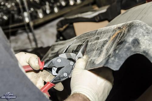

We then carefully cut the inner wheel well liner to fit the mounting bracket and reinstalled it.

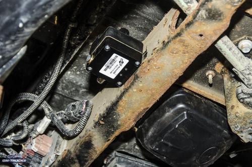

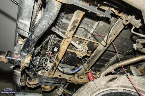

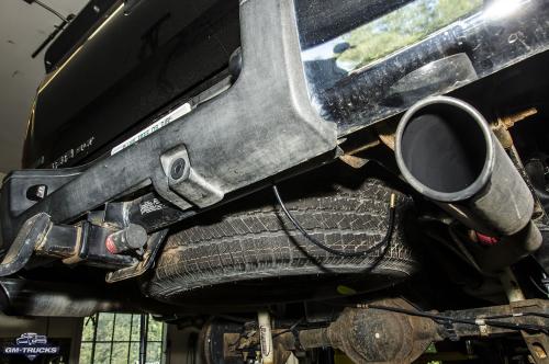

We then installed the air compressor and controller manifold under our spare tire. We chose this location because it was protected and far enough away we cannot hear the compressor running from inside the cabin.
Lastly, we ran the wiring harness to the engine compartment and connected it to a keyed power source.
After we confirmed the system inflated the airbags and none of our lines leaked, we reattached the wheels and buttoned the project up.

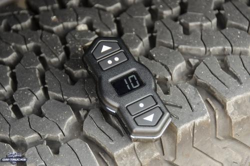

With our Sierra unloaded we got to work testing every available air pressure setting we could. The system has a minimum pressure of 5psi and should never be driven completely deflated. Conversely, the compressor has a maximum setting of 100psi, for when you’re taking your vehicle to its limit.
We found that the RideControl system significantly changed the unloaded driving behaviour of our Sierra for the better when set to between 5psi and 10psi. The air bags helped our truck’s suspension soak up bumps and settled down axle bounce at the same time. The result was a vehicle that drove with less flex, more composure, and was more comfortable than stock.

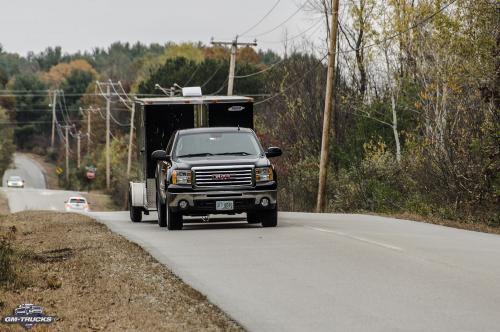

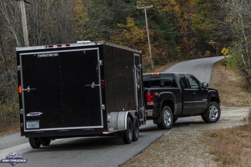

We then hooked up a dual axle 12-foot enclosed trailer stuffed with an ATV and its related equipment. This combination weighed approximately 2,500lbs. After increasing the pressure in the airbags until the truck and trailer were level we set out to see how this combination handled.
With a trailer hitched up in our rear view mirror, the RideControl system shined. We immediately noticed how level our Sierra sat, even with the extra weight in the back. This level position preserved the correct steering angle of the front end, brake distribution, and helped reduce drive line shock during transitions from acceleration to braking.
In general, our Sierra acted as if it was given a huge confidence boost.The AirLift system stiffened our Sierra’s suspension and added new found stability and capability to our last generation truck.

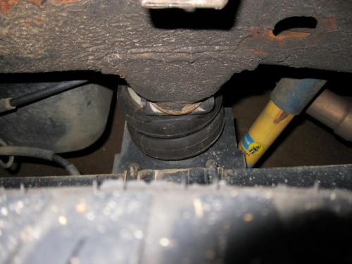

I used Air Lift Loadlifter 5000 Ultimate (with internal jounce bumpers) on my 2003 Silverado 2500HD. It did level out the load with my new 5th wheel camper and gave a great ride. However, some states are starting to check tow vehicles against their towing load. The pin weight of my 5th wheel exceeded the payload stated for the 2500. They will write you up even though you are towing with airbags. In some states/cases, if you're in an accident, it's classed as a felony. Just beware.... Even though I tow the five'r about 6 times a year, I've since purchased a 2014 3500HD dually which has a lot more payload.

I had this kit on my 2010 silverado 1500. I sent it back after talking to the company. I had tire rubbing on the air bag top plate, when the axle would articulate. It was fine sitting level. I then installed timbren ses kit. The air bags were nicer ride, but timbren are just put in and forget about them. no need to add air.

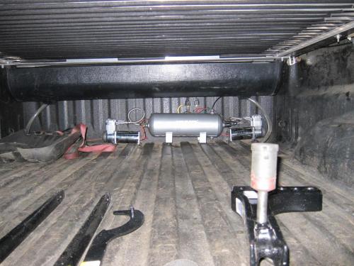

I didn't buy that automatic setup, since spending another $200+ for the pump, ect. when I already have a Viair compressor system seemed foolish. With that system back there, I don't mind airing up manually, so I gave up researching a solenoid to isolate the bags from the air tank. Buying the parts individually would end up FAR less than buying the complete system. Someday I might do it. No real rush at the moment ...
