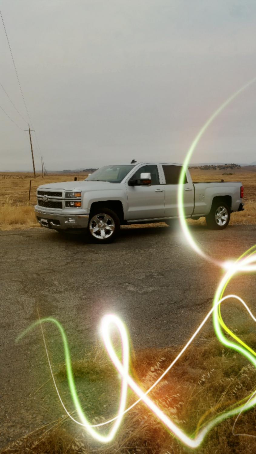

I have a 5.3/3.42 geared ccsb z71. My tt is an old 1989 Layton, 6,000 lb gross and about that when loaded and ready to camp. I also have a bed full of firewood, bicycles, ez up tent, extra water, etc and my family of 4 in the cab.
I've had the truck up in the mountains 2 times since I've owned it. It pulls the heavy Layton just fine for the 10 or less times per year i will be towing it.
Granted, my prior tow vehicles were a late 80s silverado k1500/350 and 2 ford 5.4s.
This silverado is night and day better than anything else I've ever towed with. The brakes are excellent for a 1500series pickup. On the long steep grades (11%+) i was down into the 2nd gear and around 4500 rpm, but once there she pulled very strong! It never felt strained and even accelerated once down there. Pleanty of pedal left.
It all depends on what you want out of it and how often you'll be towing. Based on your initial post I'd go 1500 max tow 6.2. Unless your going to tow that tractor every week. Towing heavy is not a speed contest, let the other rigs pass you on the grades. Take your time. Most st trailer tires are speed rated to 65mph MAX. I tow around 55-60 on the highway, take my time and enjoy the trip.
Imo, today's diesels are a pita with all the emissions crap on them, regen filters, def, and they are stinky,lol!
I really like my silverado. Yes it has some quirks but i don't worry about them. The throttle response and trans shifting has greatly improved now that i have over 3,000 miles on mine (first 1500 were annoying but i stuck with it) these new trucks have a lot of torque management to protect the drive train which leads to the lazy throttle feeling. From what I understand a black bear tune really unlocks the true power these trucks have. I won't do that till I'm out of warranty.
I also tow with the trans in tow/haul mode (which is also excellent!) And locked in M5 mode so all 8 holes always stay lit ?
Good luck in your decision. I hope this helps.
