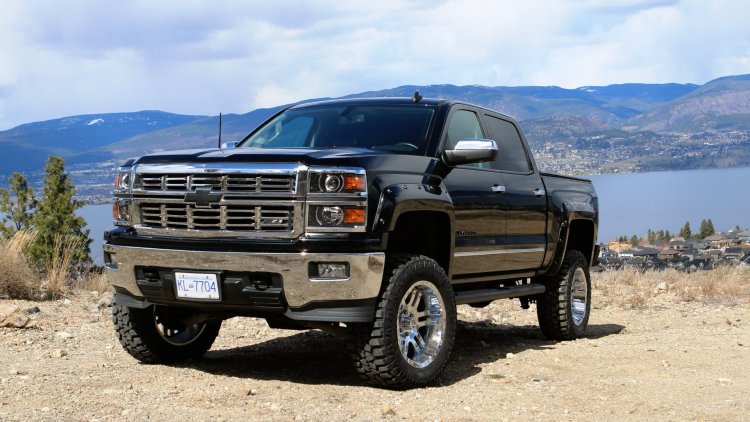

i've had the 7.5" RC lift in my truck for 2 years now
i think it rides fine and have had no issues with it... now, with that being said, my truck is a total street queen (bahahaha!) and i don't do any off roading with it.
if you are looking at doing some serious off road adventures, i'd definitely lean to a much heavier built kit

honestly - i don't have a clue (ha! ha!)
i'm pretty sure this is the kit that was put in my truck...
https://www.americantrucks.com/rough-country-75-suspension-lift-kit-w-shocks-1417-4wd-w-stock-cast-steel-or-aluminum-control-arms.html
like i mentioned in my original post - it's been fine so far and rides great...  well... as great as any truck with 35" mud tires will ride

That is a strut spacer kit. They have a newer kit that utilizes "Vertex" adjustable coilovers with remote reservoirs and reservoir shocks in the rear too. It's supposed to a world of difference, but I haven't been able to find anyone that had actually used them or reviewed them yet.
