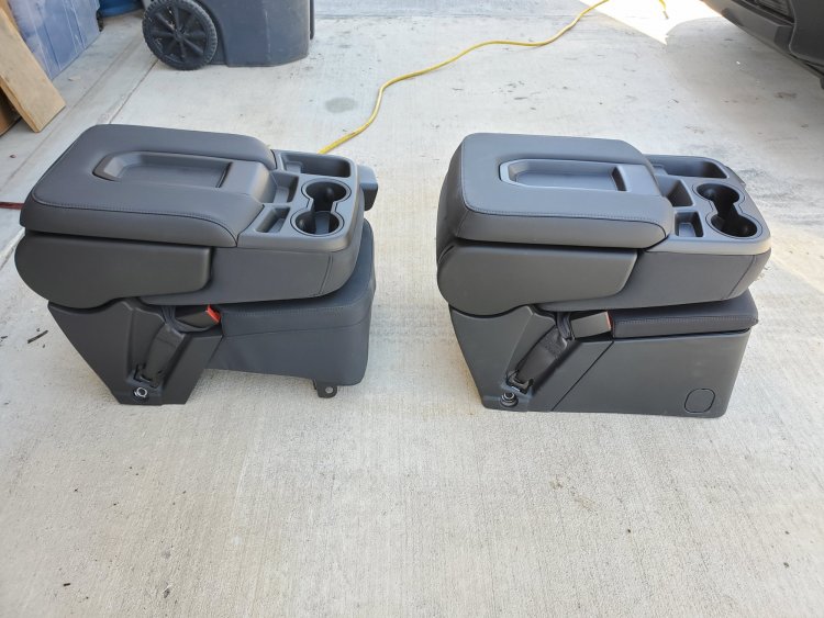

On 4/3/2020 at 8:10 PM, Ranger Barlow said:
That's a great comparison picture there.  Before I bought the replacement center seat for my truck, I was always trying to see if I could discover from the pictures if the console had the storage or not.  Especially when I was looking through the pictures on car - parts . com, where I eventually got my center seat.
From this angle, you can really see the difference between the two.  The one on the right, with storage, shows how there is an angle where the cushioned leather part meets the hard plastic front, where the one on the left that doesn't open, meets the hard plastic differently.  The bottom part is really obvious!
Thanks for taking the picture, and hopefully it will help others.

Found a center console with storage on Ebay.  Got it swapped in today.  One of the things I noticed was that the seatbelt anchor is attached to the frame of the console.  I was just gonna swap the top but ended up replacing the whole thing because of that.
