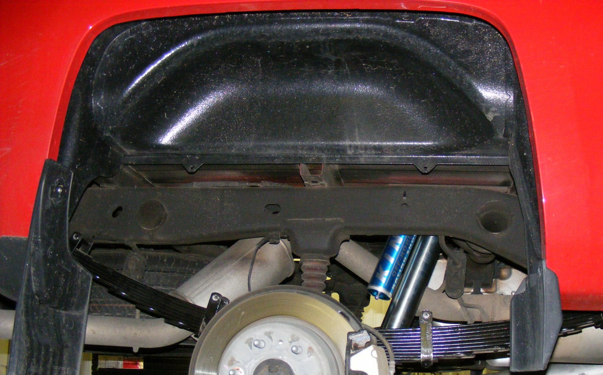

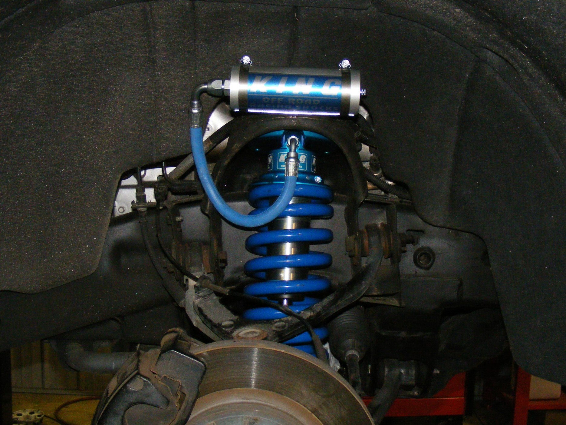

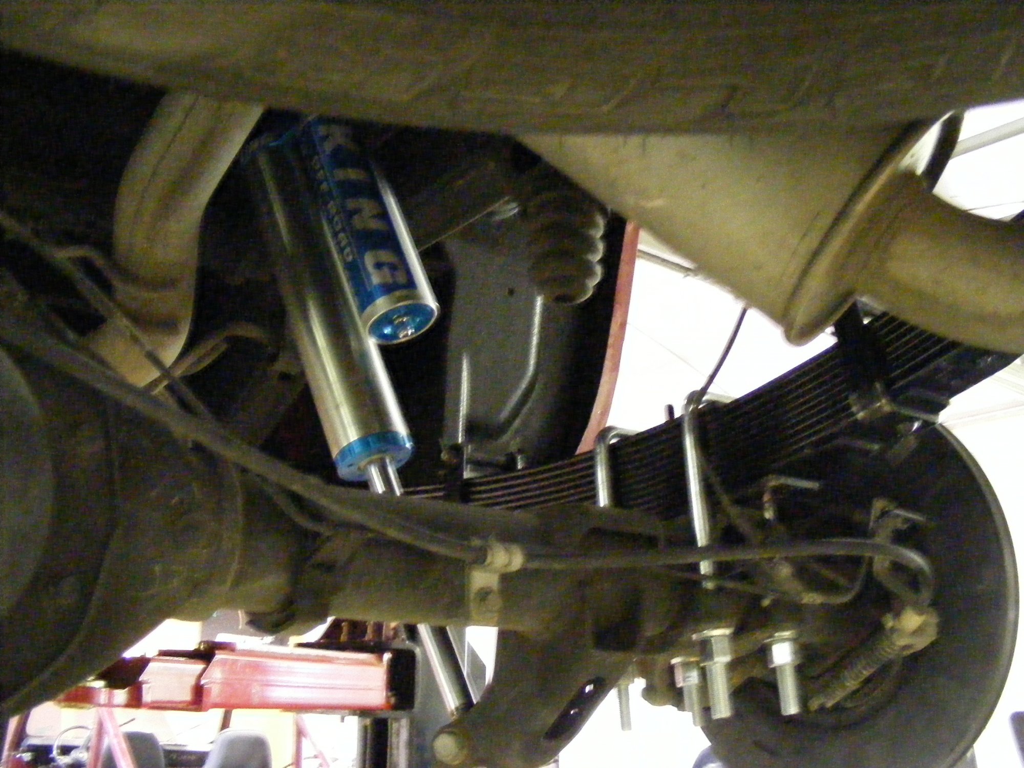

1 hour ago, TXGREEK said:
Mr. Grumpy, would you mind posting your front and rear suspension
Click on the photo for a full screen shot.
I found out that the Bilstein 5100 actually has a shade over 4" of stroke. Factory shocks are 3-1/8" or so.
DSCF3007.JPG.c513ee29f5bf7a1f44071d4f7c1f629e.JPG DSCF3008.JPG.e9ffa036e22628255206ca170c9ebac1.JPG DSCF3009.JPG.d219b7e89c7fe4d73252aed235372951.JPG
Absolutely beautiful! I wanted everyone to see the King versions too. Both have front coil overs but you’ve also got front resi’s too.
I love my setup and bet you love yours too. Night and day difference from stock, almost gets you in trouble looking for something to tackle lol
Sent from above

Thanks, exactly what I need. Curious as to why you opted for the Kings in the rear instead of an all Fox setup?
My setup is CST front and back. Grumpy’s is Kings front and back.
Yes, I do love this setup and thank you. Did you notice I run stock UCA's?
