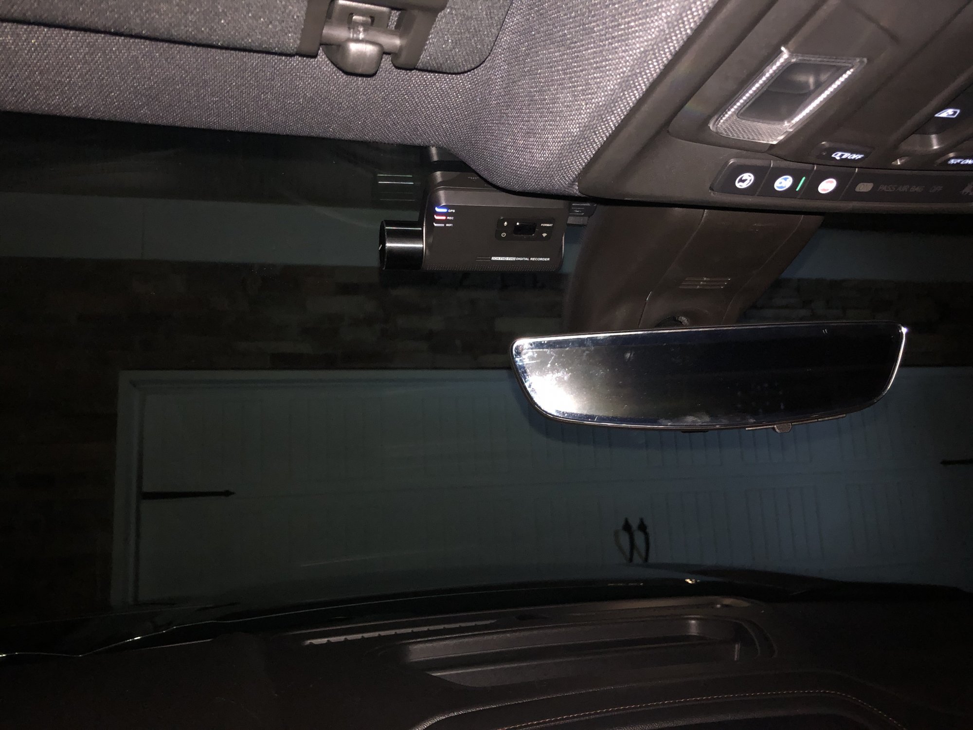

So I had my local dealer install the GM accessory cam.  I think they mounted it in the wrong place.  Thoughts?
