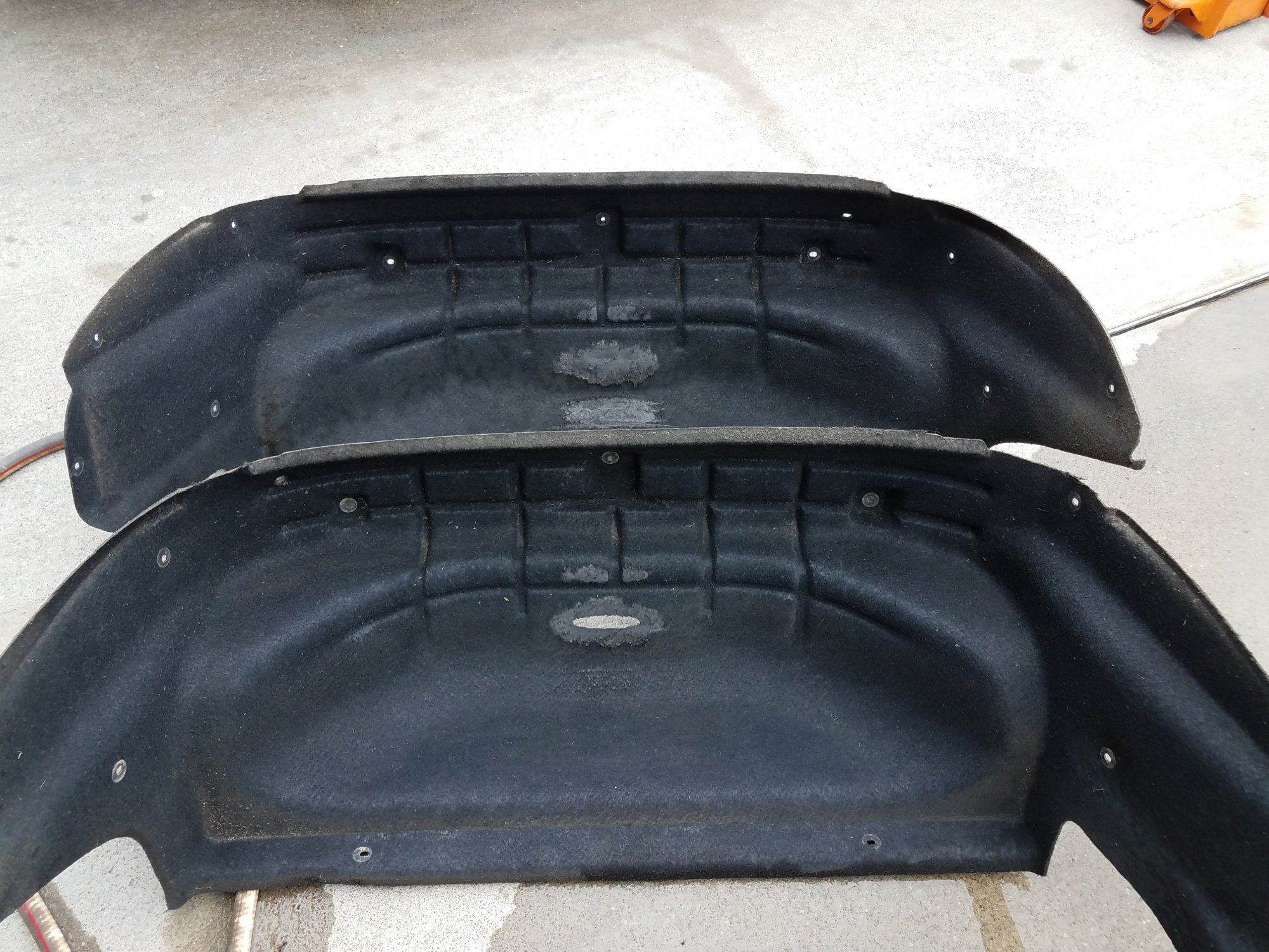

I took my rears out last weekend to install new liners. I didn't take any pics while the liners were out but I saw nothing to make me think there would be rust. I did take a water hose and towel and clean everything up really nicely while the liners were out. I made sure the wheel well lips were really clean before installing the new liners. There was really not much dirt behind the liners even though the old ones were worn through.

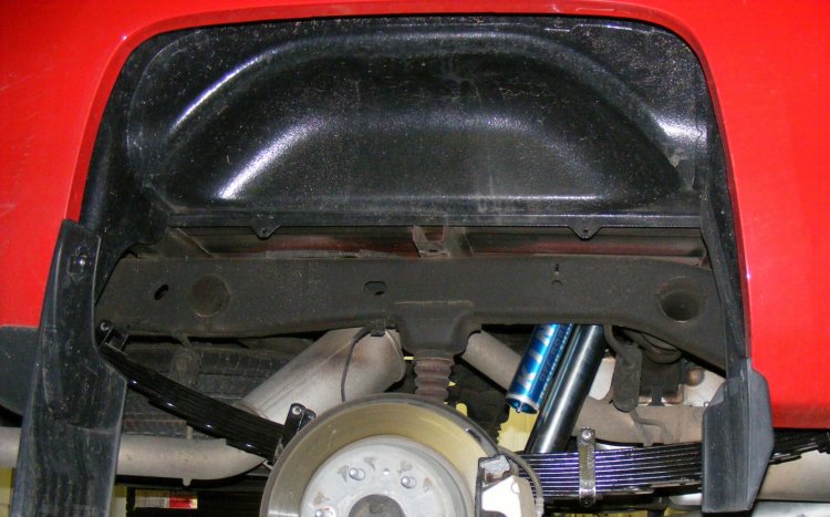

Line-X Premium that covers the body to wheel well seam and plastic attachments. What dirt you see hoses out and looks like new. Very easy to maintain.  There are a couple of plugs in the bed above the wheel wells that allow hosing with a wand with out removing the tail lamps. Good place to add oil to the seem for those so inclined.
