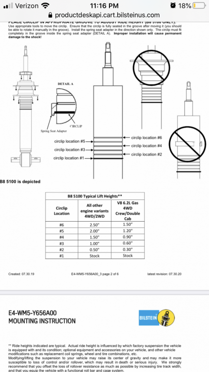

So with the new 5100s up front for you TB/AT4 guys. Anyone have them set at the highest to “level”? Wondering if I can set them at the highest level will help with the massive rake...or do I need to do like a SST kit or even a 1” MotoFab..?
The highest setting is only 1.1" I believe....that isn't going to level a TB/AT4.
They go up to 2.5” unless you have the 6.2.
