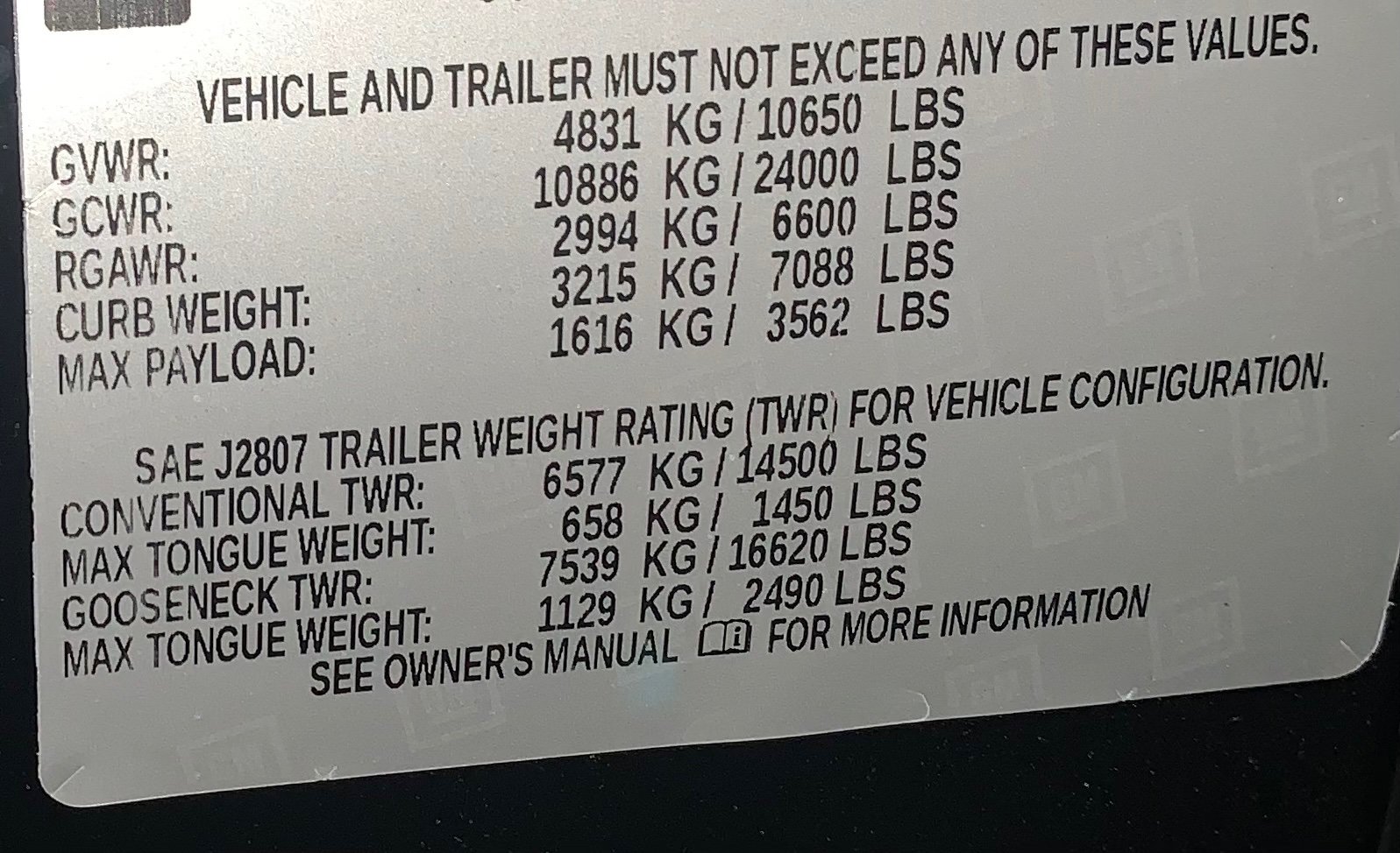

Mine (22’ LT CCSB Z71, 6.6 gas) has a payload of 3562, but I don’t have a sunroof, 5th wheel prep, or extra battery. My GVWR is 10,650. For additional reference, my dad has a fully loaded 21’ LTZ Z71 w/ the Duramax. His payload is around 3350. He has the 5th wheel prep and everything.

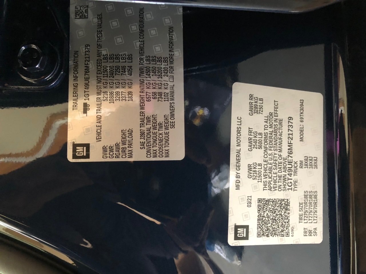

Here is a gas 2020 LTZ, crew standard box with 20"s, LTZ Convenience 1 and 2, no sunroof and VYU plow prep:
