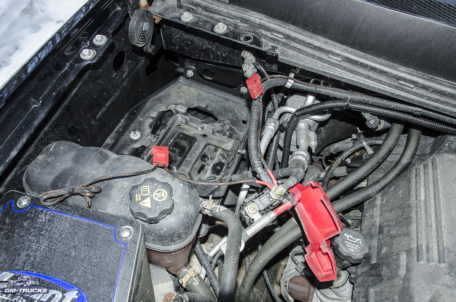

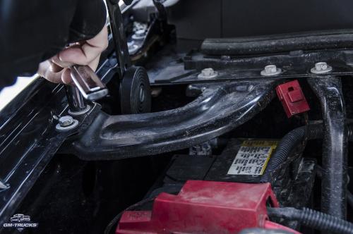

Step Two - Unscrew the engine bay bracing
The battery in the older 2007-2013 body styles and newer 2014+ body styles are surrounded by bracing. While the designs are different, all model years require a 1/2-inch socket to remove the bolts. Remove the bracing and set aside in a safe place.

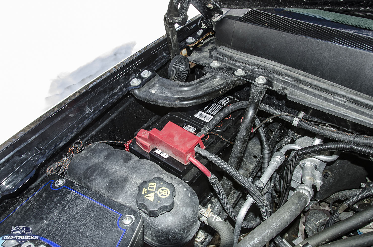

Step Three - Remove the battery hold down
The battery is held in place by a single 13mm bolt and block. Simply unscrew the hold-down using a socket and the 6-inch extension, Set aside in a safe place.

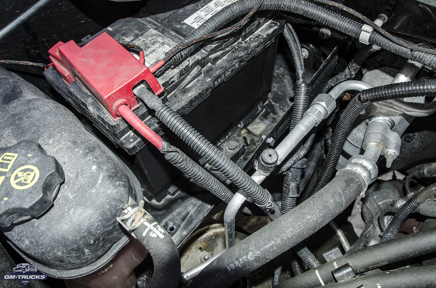

Step Four - Disconnect the old battery
Now, disconnect the battery using a 10mm socket. Be careful to remove the negative terminal first and never allow the positive and negative wires or terminals to touch.

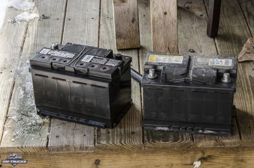

Step Five - Switch the old and new battery
The battery weights around 40lbs, so make sure you are comfortable lifting this much weight to around shoulder height.

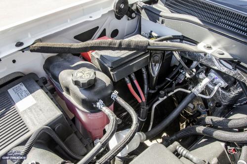

Step Six - Reassemble in reverse order
Simply reattach your battery, battery hold down, and engine bay bracing in the reverse order.

Good write-up. You mention to remove negative cable first, which is correct, but I think it may need a little more information as to why you remove negative first. Can't tell you how many times I have heard people say to remove positive first, because it is the cable with the power on it, and you want to disconnect power first.
When you are removing a battery, and both cables are connected, removing either wire will remove power from the vehicle. The thing to be aware of though is that with the ground cable connected, and you put your wrench on the positive cable to remove it, the wrench may slip or move suddenly and touch the fender or any metal brace in the area, which will short tjhe battery to ground, usually instantly welding the wrench to both the nut on the battery cable and the metal it hit. The wrench will get red hot, and stands a good chance of causing a fire at best, or explosion of battery at worst. If you remove the negative cable first and the wrench slips, it will touch ground, which is what it is connected to on that terminal already. No damage other than maybe chipping the paint.
