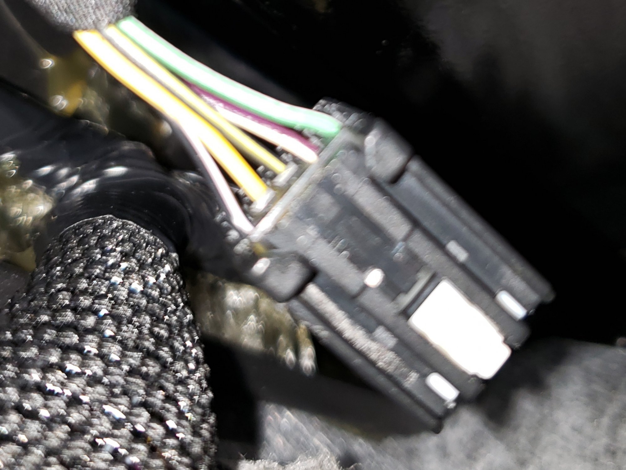

First, thanks to all the people who posted pictures and descriptions. I was able to get my mirror knocked out in about 30 minutes, it would have been much longer if not for all the help.
Second, did anyone else have to deal with this much glue on their harness. Hahaha someone in Mexico loved the glue gun. I had to cut some of it out and then get a pair of pliers on them. 76eabaef98726427cb5181c0c8ceeabd.jpg
Sent from my ONEPLUS A6013 using Tapatalk
Haha, mine was from USA and she was glued on with a fair amount.. if someone has a heat gun it could help not destroy the housing.
The back of my harness clip was ripped off with the glue, thank goodness it wasn't the end that clips in.. and I tapped in so it was okay.

Yesterday I installed this rear view mirror. The plug for the mirror was not compatible with the plug glued in the headliner so I had to do some splicing. I found a constant wire that powers the overhead lights nearby. Hooked the homelink up to that. bc66800a97623ecb02a7315e2801ea03.jpg
It looks like you bought a very fancy rear view mirror.
My Silverado didn't come with homelink so I got that mirror on Ebay for $50. Also has autodimming.
