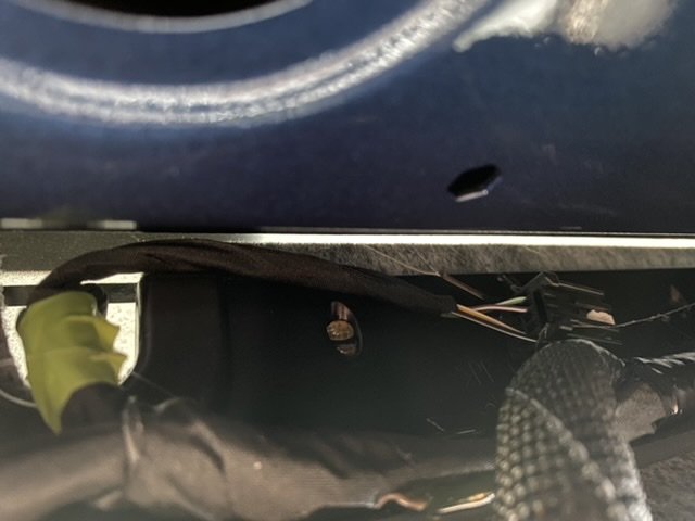

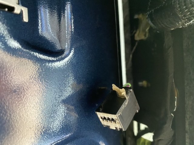

   I installed a dash cam and tapped off the mirror power wires. I can confirm purple/white 12v switched on and black/white is ground. The mirror power wire is only powered when the ignition is turned on or accessory power. Camera powers off when truck is switched off. I plan to do a how-to write-up for the dash cam install but just haven't gotten to it and still haven't purchased my auto-dim mirror. Pics of some of the install below.

Which mount is that you used on your camera ? looks like a new Blendmount type
It's the blend mount from my camaro that I traded in for my truck.  It works but really isn't the correct blend mount for the silverado but, right now don't really want to spend another $100 for a new mount when this one works just fine. Love their mounts for the clean install look.
I was gonna say it works and looks better then mine.
That camera install is pretty amazing!  unfortunately, I'll never be able to take that plug out again due to the bad shape it's in from it being unnecessarily glued to the roof of the cab.
