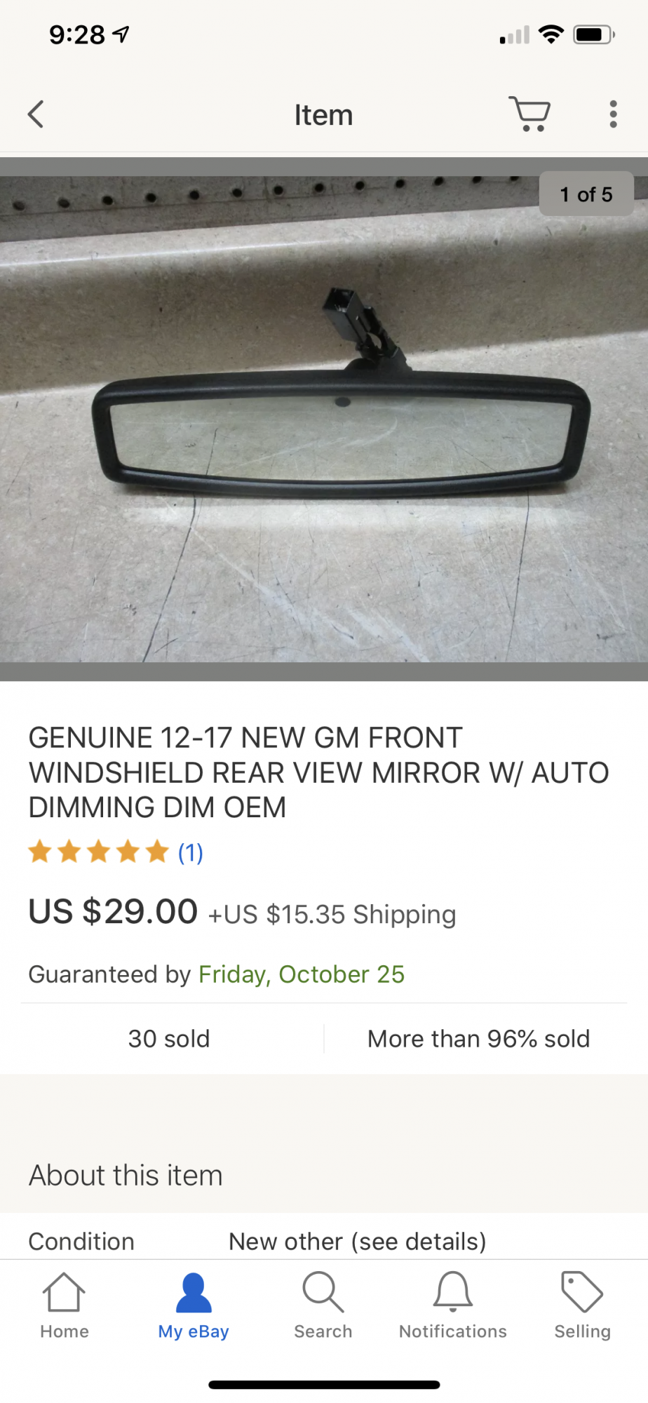

It literally just plugs in.  They may have only noticed the larger harness.  But there are  no modifications needed to the mirror harness.
Yes,
Double check their work. I bought that exact one and it was plug and play. They might not have pulled down the right connection.

Thank you!  You are correct. Installed myself in less than an hour. The dealer tech either saw the large unused plug when he took down the console or saw the plug behind the black plastic cover on the windshield. I am not sure what that is, but everything fit under the cover when I put everything back together. Hardest part was getting the plug unstuck and cleaning glue off so  it could plug into the mirror.

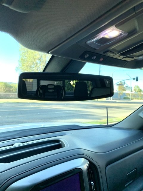

First time Truck owner here! (2019 Trail Boss LT) Just want to say thank you to all of you for this and other topics to help me get to know my truck better. I changed my mirror following your instructions, and suggested parts. It’s perfect!

Just want to thank everyone in this thread for the info !  I ordered the GM Part 13581082 as listed in this thread.  I followed the instructions and installed this in less than 30 minutes in my 2019 Silverado 1500 RST.  The plug was glued in the ceiling pillar as noted and I had to use a flat head screwdriver to pry it off the metal, but it works like a champ.  Still not sure why this is not included in a truck that costs as much as it does, but the upgrade was easy enough.
