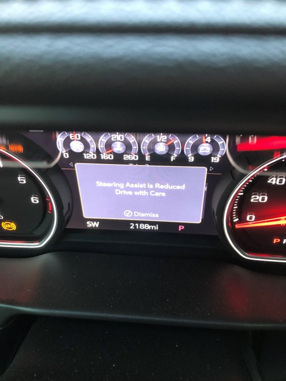

12/15/2019 I did a “Remote Start” off my “My Chevy” App. I went down the road for about ¼ mile and the following warning lights were lit on my dashboard: Check Engine, ABS, Traction Control and Brake. I had the following messages on my “DIC”:
a.      Brake System Failure 62 MPH Top Speed
b.      Steering Assist Is Reduced Drive with Care
c.       Trailer Brake System Failure
d.      Service ESC
I could tell my brakes and steering were compromised, so I pulled over to the side of the road and shut the truck engine off. When I restarted the engine all the messages and warning lights went off except for the “Check Engine” light. The brakes and steering seemed to be working as normal. I received an email from OnStar indicating an issue with my Antilock Braking System had been detected. Before I got home, I experience a complete Blackout on the Instrument Panel. It came back in about 3 seconds.
12/16/2019 I called Crews Chevrolet and spoke with Service Advisor Ms. Bailey who has been my Service Advisor and explained my latest problem with the Silverado. We changed my appointment to Tuesday 12/17/2019 at 1500 Hrs so the Technician would have more time to trouble shoot the problems. She advised she would set me up with a Rental Vehicle since I would probably need to drop the Silverado off for a couple days.
I did another “Remote Start” off my “My Chevy” App and received above same messages on the “Driver Information Center” as well as the same Dash Lights. I had to shut off the Silverado and restart it 3 times before the messages and lights went off with the exception of the Check Engine light remaining on.

12/24/19 While driving I discovered the Lane Keep Assist, Forward Collision Alert, Following Distance Indicator as well as the Automatic High Beam were no longer working. The Tailgate Power Lift does not work from the Key Fob. It lowers but does not raise. It will work from the control in the truck.
12/25/2019 I did a “Remote Start” off my “My Chevy” App. When I entered my truck and pressed the Start button the same warning lights as before were lit on my dashboard: Check Engine, ABS, Traction Control and Brake. I had the following messages on my “DIC”:
c.       Service Trailer Brake System
d.       Service ESC
I shut the truck engine off and restarted the engine four times before the “DIC” messages cleared and the Instrument warning lights went off except for the “Check Engine” light. I received an email from OnStar indicating an issue with my Antilock Braking System had been detected. Before I got home, I experience a complete Blackout on the Instrument Panel. It came back in about 3 seconds.
