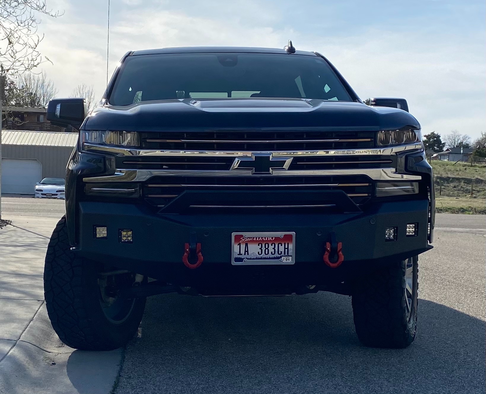

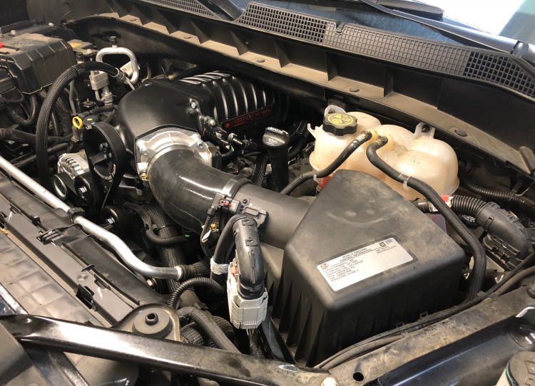

I dropped the truck of at the dealer this afternoon to have the Whipple installed.  They claim it will take 11 hours, so I should have it back on Friday.

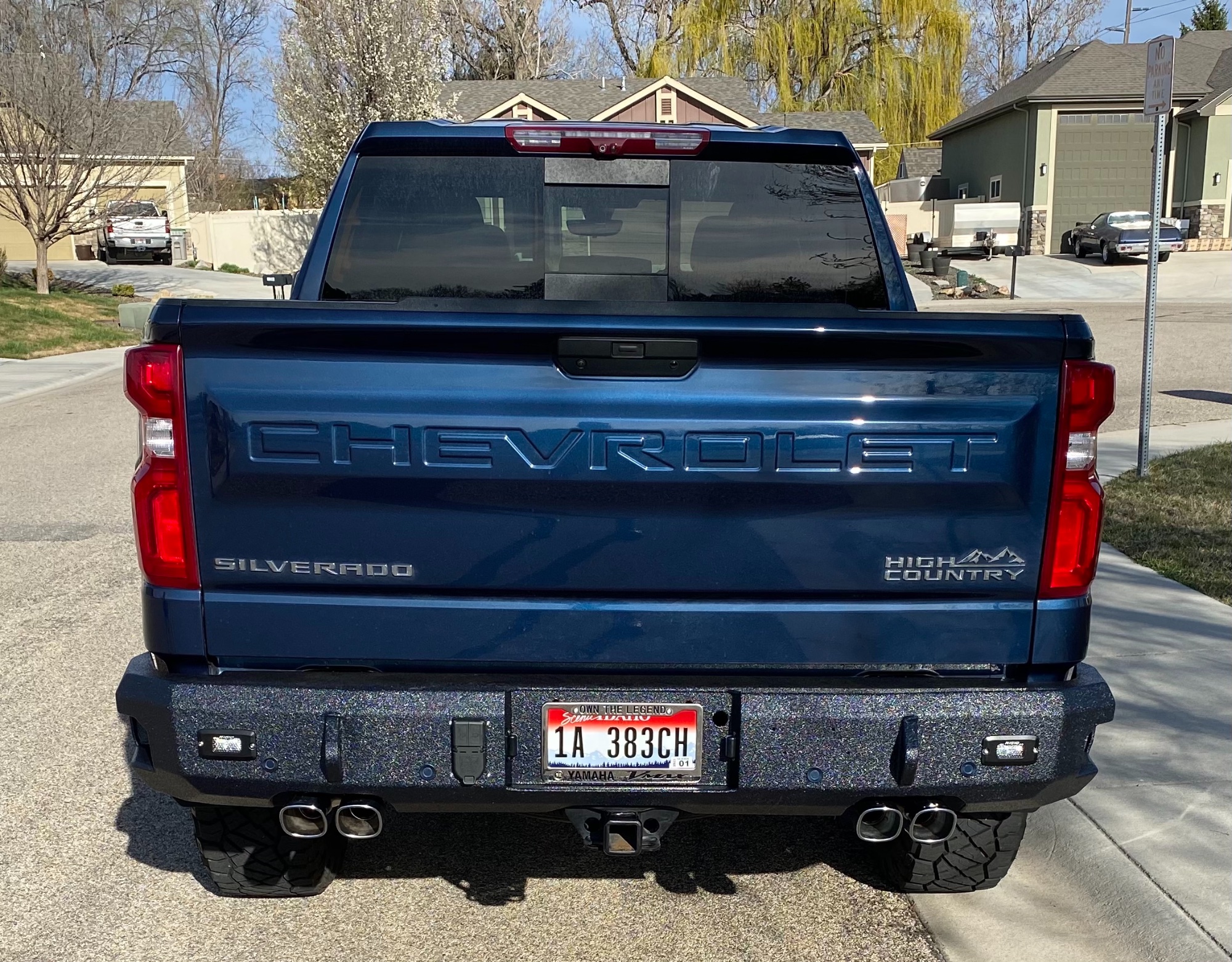

I installed a Borla True Dual S Type cat-back exhaust with the optional resonators to bring the volume down a bit.  It really sounds good!
I ordered a new ECM from RockAuto for $200 and sent that to HP Tuners to be modified.
The Whipple took less than a month to be delivered, so I was a caught off guard when I got the shipping notification and “had to” (read: wanted to) rush to get everything set up for the install.
I want to maintain the good relationship with the dealer I bought the truck from, in hopes that, if there are any warranty issues with the truck that could be questionably related, they will work with me. That, and they have been good to me on the other mods I have had done. It also has the Trail Boss lift with an extra inch to level the front, new wheels with 35X11.50R20 Ridge Grapplers and it has Road Armor Stealth bumpers on the front and rear.
I am excited for the the outcome!

Nope, don’t have it yet.  The tech ran into two problems.  The belt that came with it was too short and there is a T fitting on the rear of the SC that is leaking.  They are working out the T fitting issue and they are saying that it won’t be today…
Tee fitting sounds like the intercooler hose inlet/outlet.  Damn.
It was an o-ring that had rolled and was damaged.  It is fixed an running.  They have a little more bleeding to do on the cooling  system and an extended test drive and it should be done.  They just ran out of time today.
