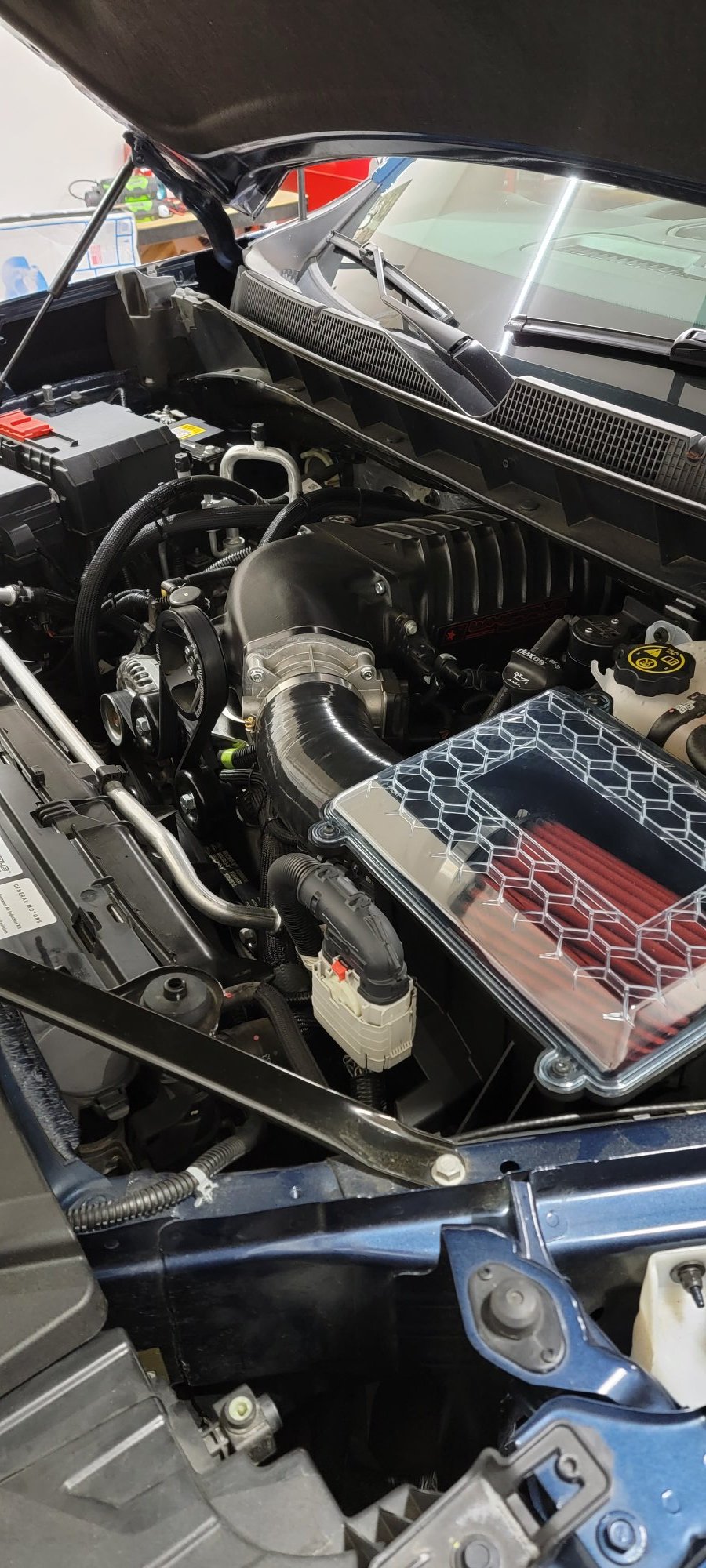

Havent heard anyone mention a cold air intake and a supercharger together. I installed the GM performance intake. I liked the rotofab and the afe, but with how the intake tube and the maf is mounted, they would have required some customization. The GM is a direct fit, which is what i wanted.
Definitely will improve airflow. Mainly installed as I'm looking to get a functional ram air hood evetually, at which point ill take the plastic top cover off. The hoods funnel air and dump right over the top of existing filter location.

I didn't pursue a CAI due to the tune not supporting one.
I hear ya... but Whipple's tune was making me regret the S/C altogether. At least for me, the powerband was inconsisent and erratic. This seemed to be further complicated by the 10 speed not knowing where to go next. Idle even seemed rougher than i liked.
Didnt want to spend more money, but the pcm is already unlocked.. so gave it a shot.
Ideally done on a dyno, but theres a couple good remote tuners that can do everything via email. Literally a couple. Need to understand what you're doing with fuel tables, timing, neural network, etc. More bang for the buck on a dyno, but even a remote tune was lightyears ahead of the canned tuned.
If you're happy with the Whipple tune, I'd say it probably isnt worth it. To each their own.
The CAI does seem to help, low to mid throttle. I'd say it was just in my head, but mpg has been up too.
