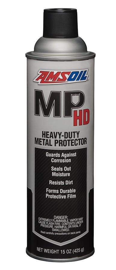

Cosmoline is some nasty stuff.  Had to clean that off equipment that we got in while I was in the Air Force.  Sticky nasty stuff that was hard to get off so it would be great but then it would also attract dust and dirt.
AMSOIL's Heavy-Duty Metal Protector would be a good choice to coat underneath a vehicle.
