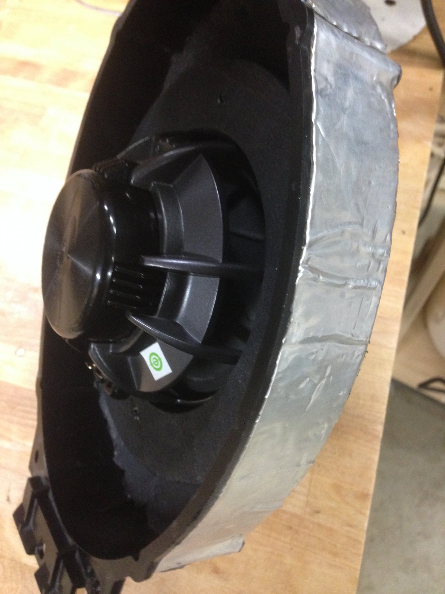

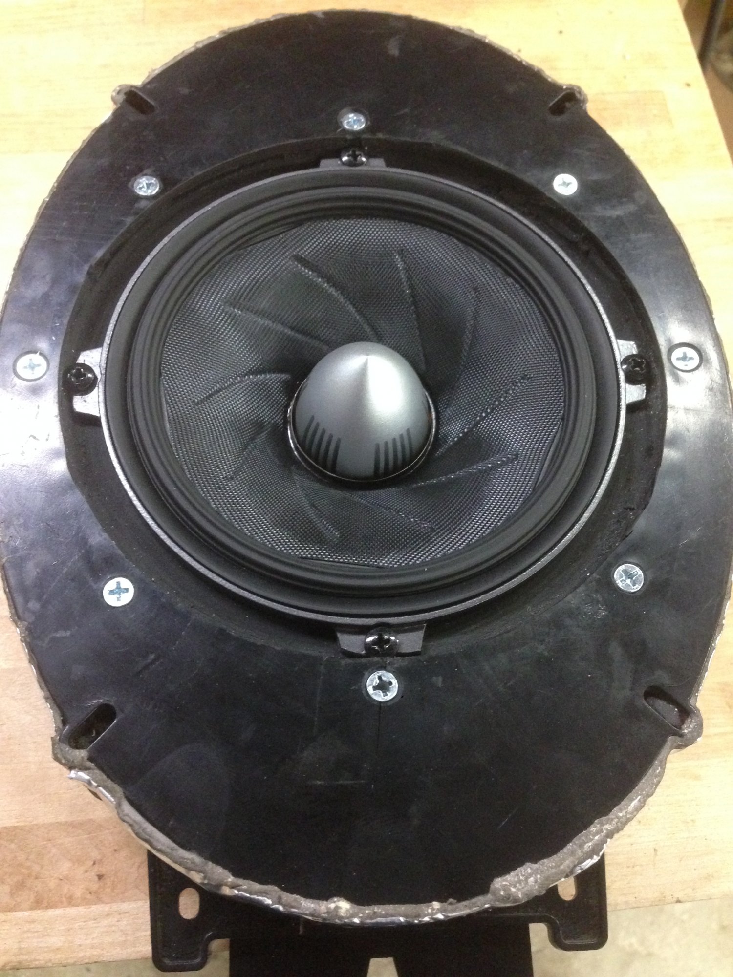

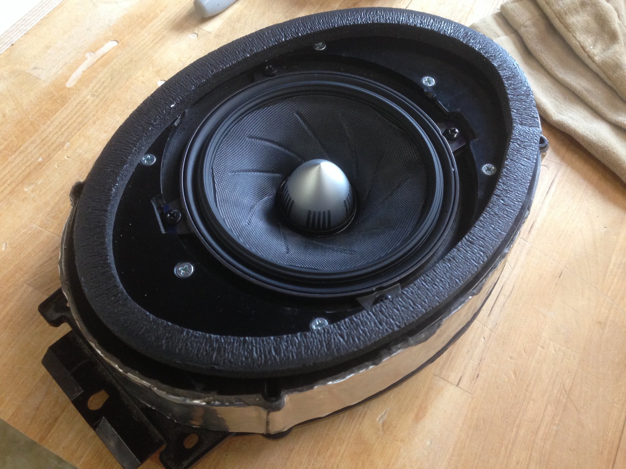

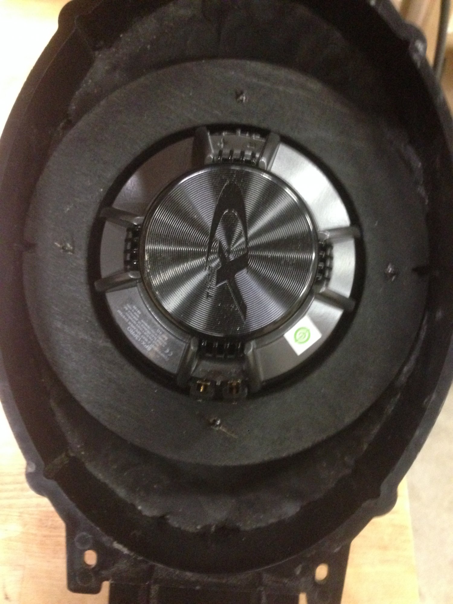

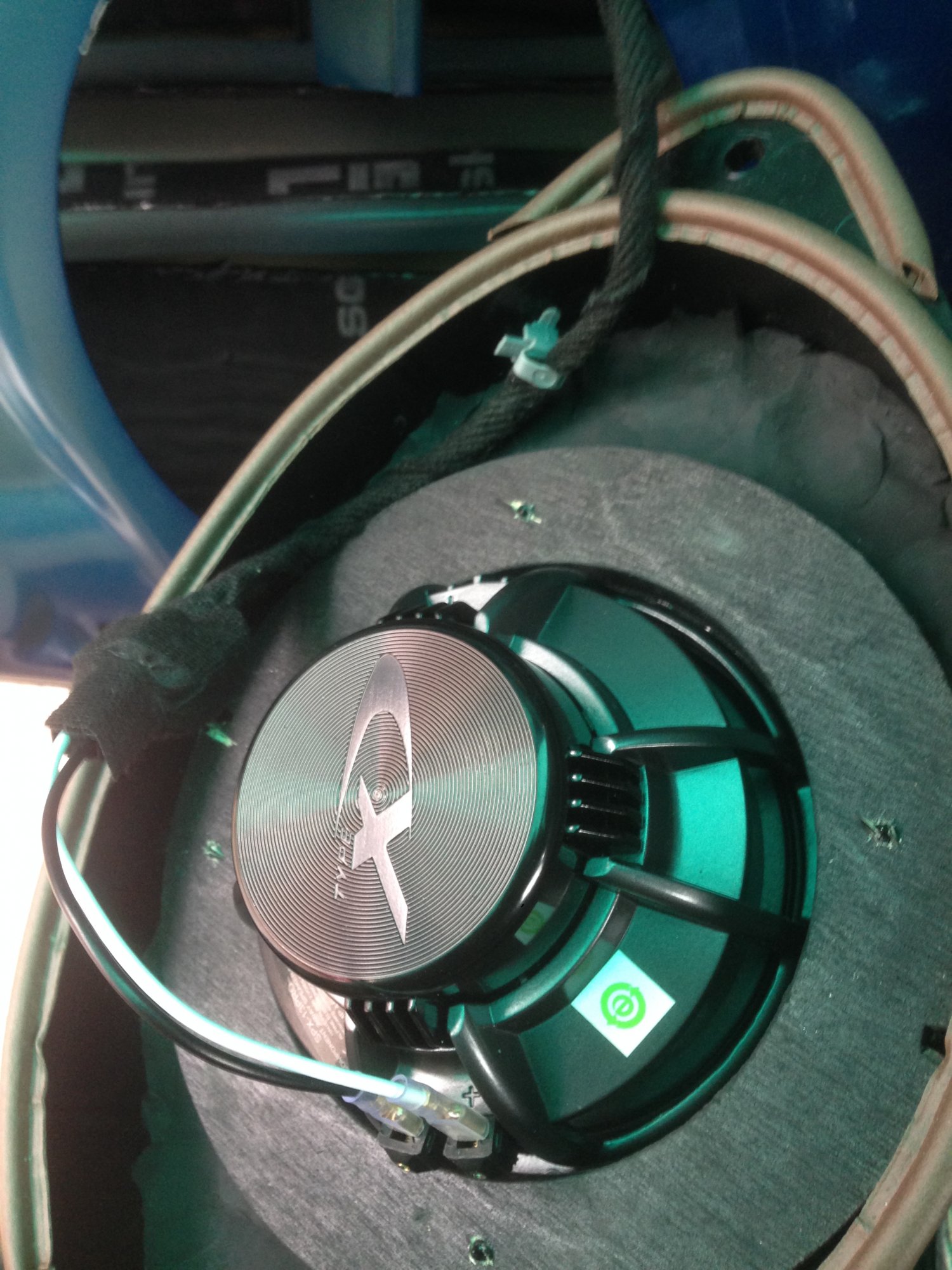

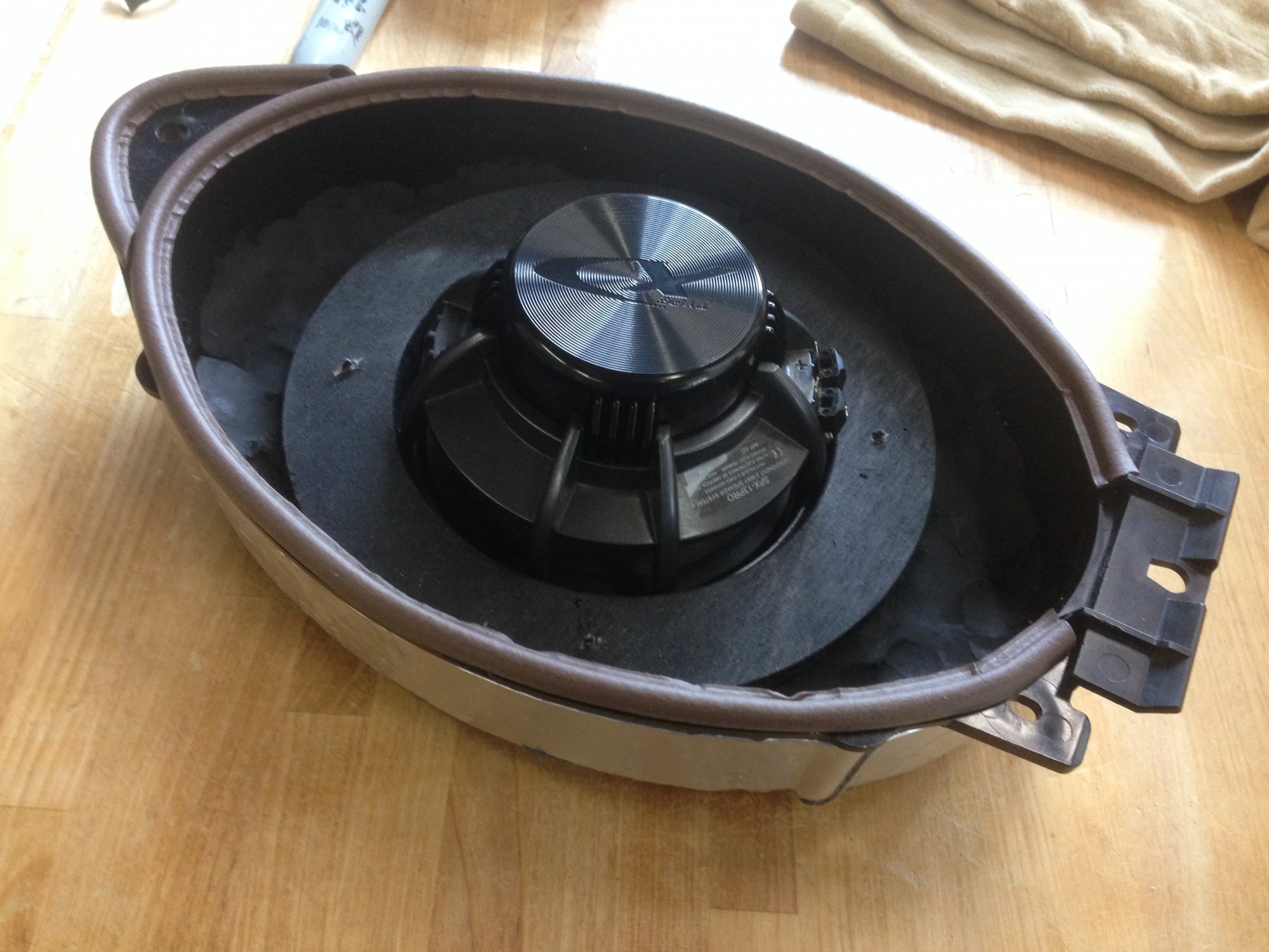

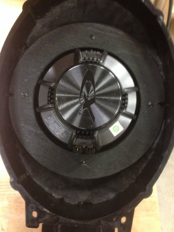

Got the mids ready to install using Metra adapters with birch mounting rings packed in modeling clay. The outside is wrapped in sound deadener and I'll use foam weatherstripping to seal the adapter to the inside of the door panel.
  • Like 3
20 minutes ago, Nasty said:
Never thought of using modeling clay ?
I use the non hardening stuff from the craft store. It's very dense and sticks well even to plastic (says it's recommended for 4 year olds so I think it's safe for us to use! ?)

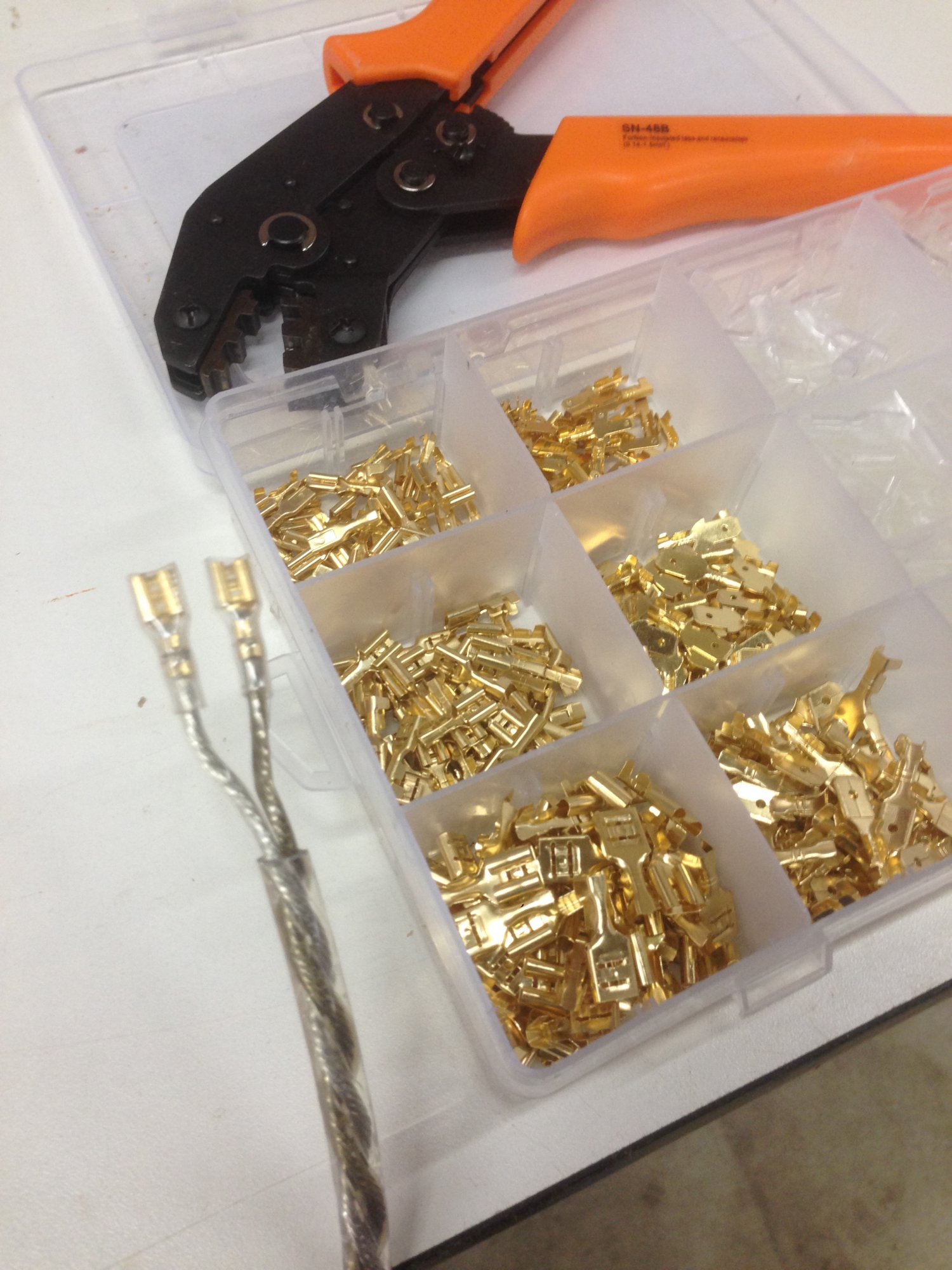

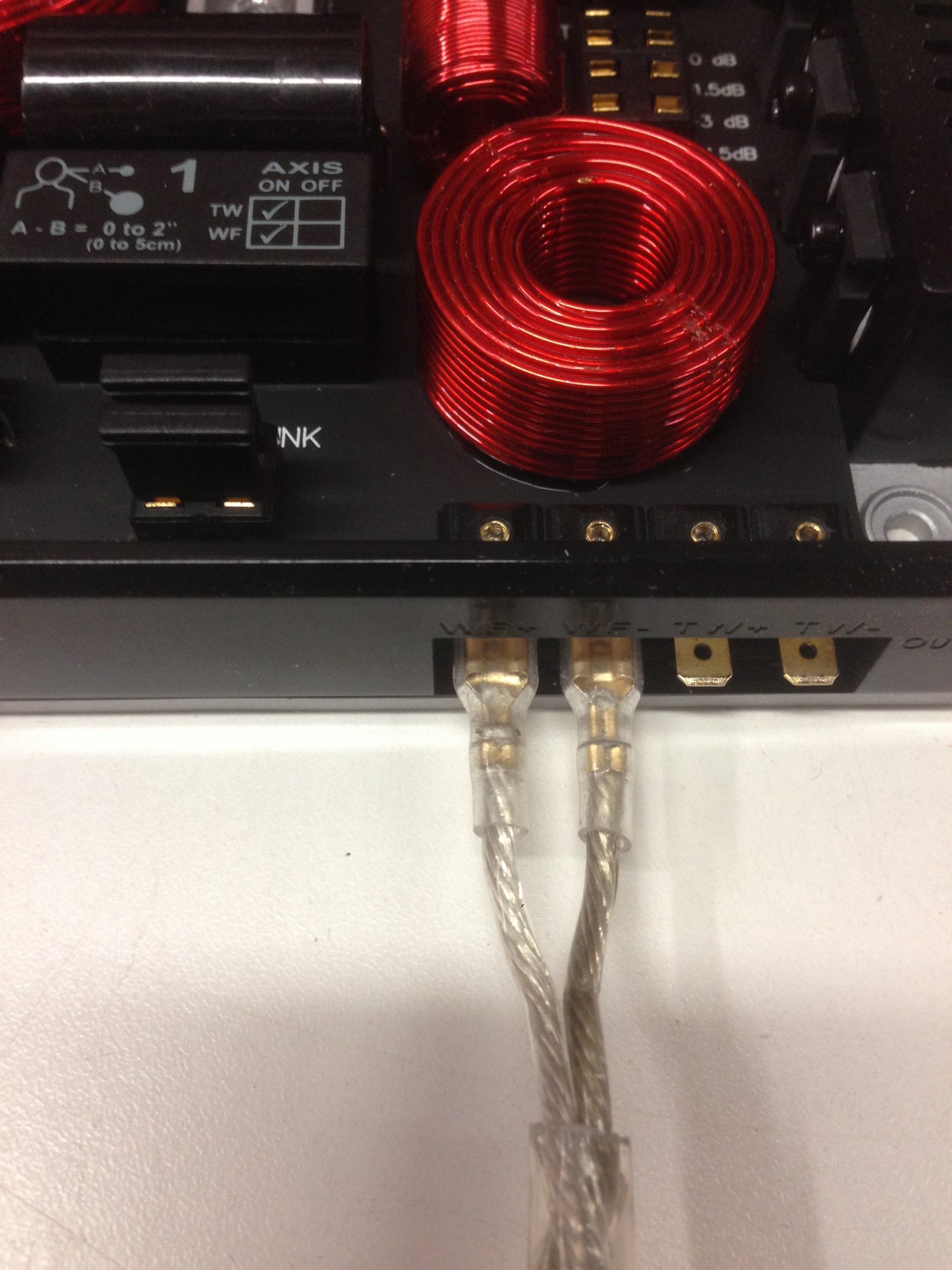

Picked up this kit to make terminal ends for the crossover and speaker wires. It came with a ratcheting crimp tool as well as silcone insulating sleeves and imo they look better than the typical crimp type insulated connectors.

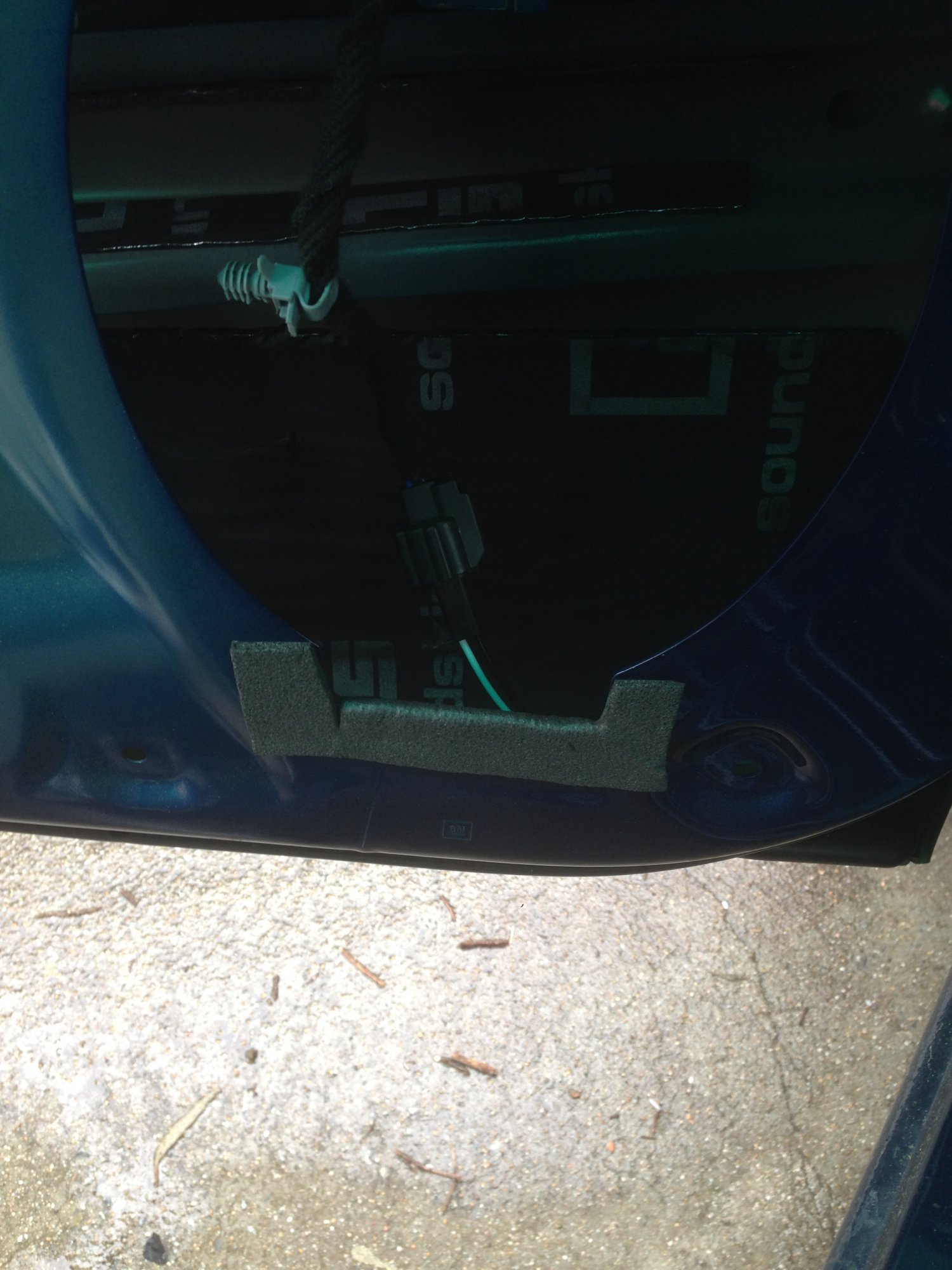

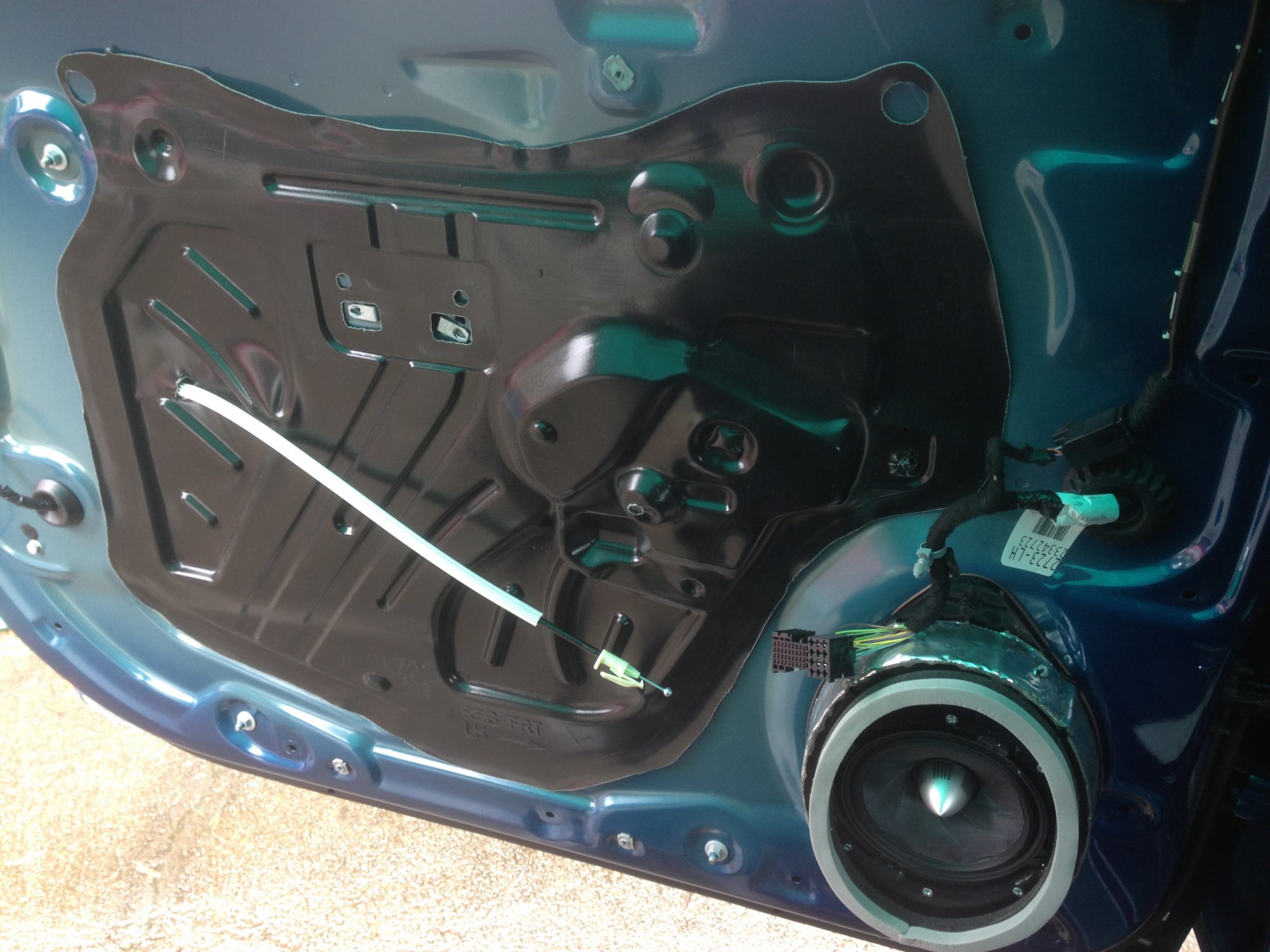

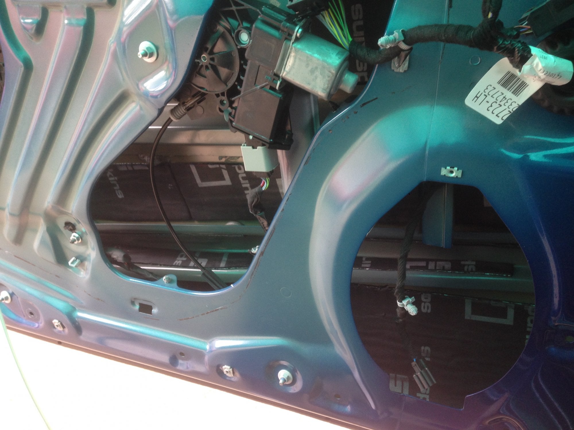

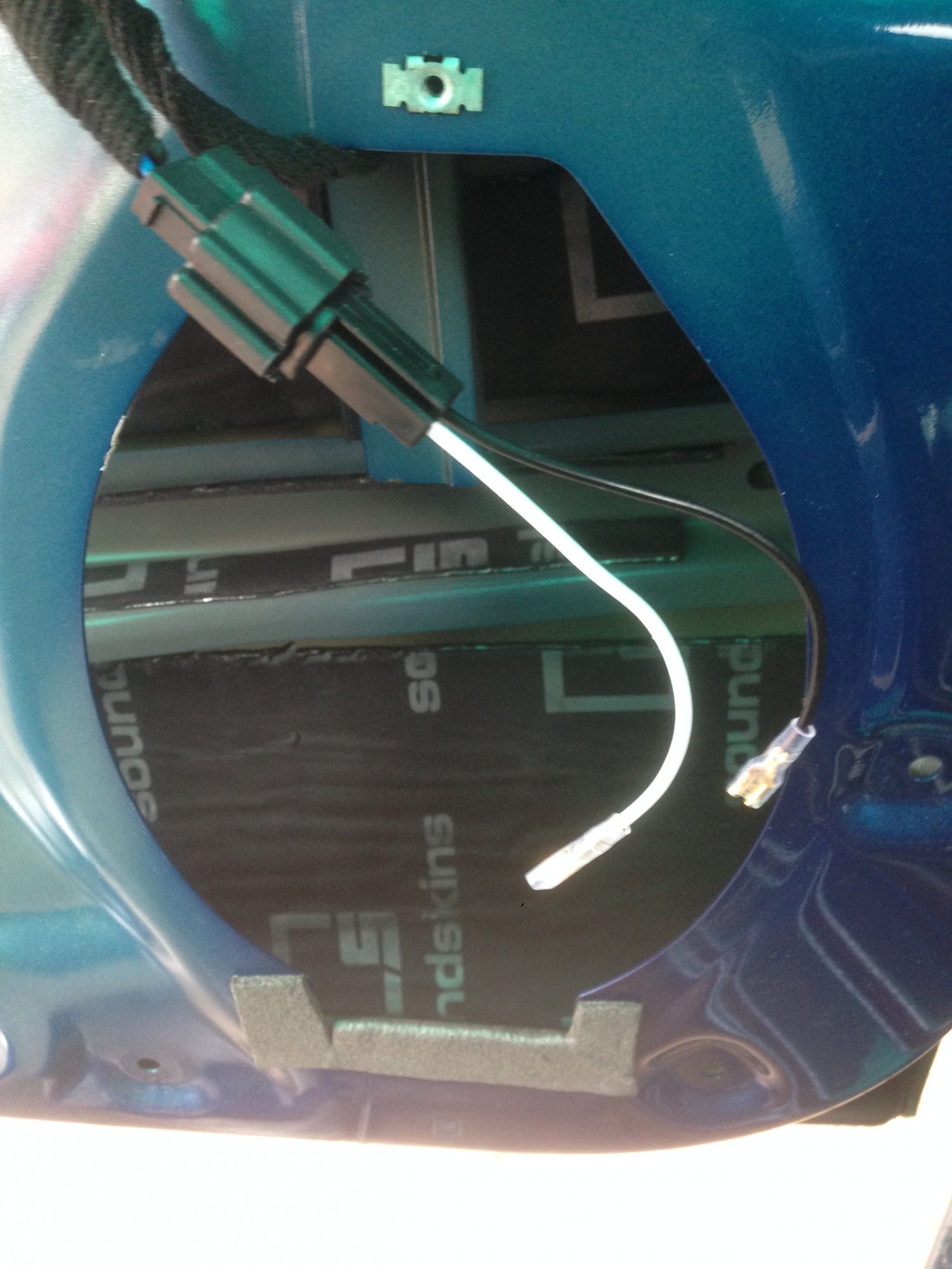

Got the drivers door done. To knock out the resonance and block high frequency noise I used SoundSkins mat with pre attached foam on the inside of the outer skin and Raammat on the inner frame (the reason you can't see the mat on the inner frame is because I put it on the backside and kept the factory vapor barrier). There was already some noise barrier on the back side of the door panel so I felt it would be redundant to use foam on the inner skin.
To make wiring easier I just used the Ford speaker wire adapters and tapped in behind the kick panel.

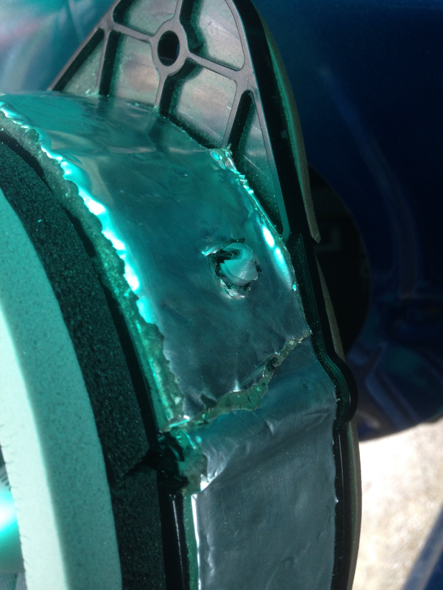

To seat the adapter to the door I used rubber window seal and I used weatherstripping to seal the front to the inside of the door panel..
To keep the wires out of the way of the window I drill a hole in the speaker adapter to use the factory pin and I wrapped the wire adapter in cloth tape to keep it from rattling.
The 3/8" thick weatherstripping wasn't thick enough so I added some sponge foam to make sure it was snug. Also, the speaker adapter was a little sloppy at the bottom so I added sponge foam to snug it up (the adapter actually  has holes at the bottom but I didn't want to drill into the truck)
