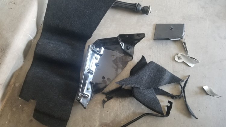

Cutting for the 35" tires proved to be quite a task since I wanted to make sure there was no contact at full bump and full lock.

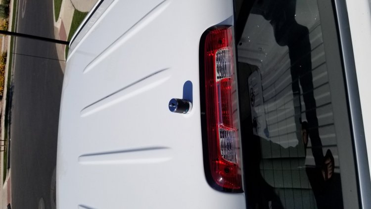

For the VHF radio, I decided to go with PCI's Chase Kit system that includes a permanent NMO attena, 50 watt race radio, and handheld mic. I had an older 7" Lowrance GPS just sitting in the garage, so I recycled that one into this "mini build".
Drilling into a few day old vehicle is always fun!

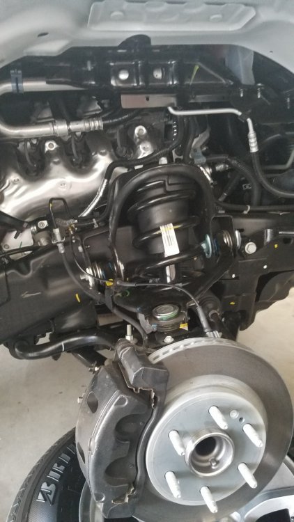

Once I picked my King shocks up from the local Safeway, I head straight home to start tearing apart the new truck!
TO BE CONTINUED BELOW
Just 2WD? Why? Are you going to make a PreRunner?

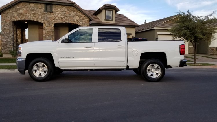

Here's the completely bone stock truck with 35" tires and no rubbing!
Once I got the wheels off the truck, I almost started to feel bad about ripping off the shiny new parts... almost!

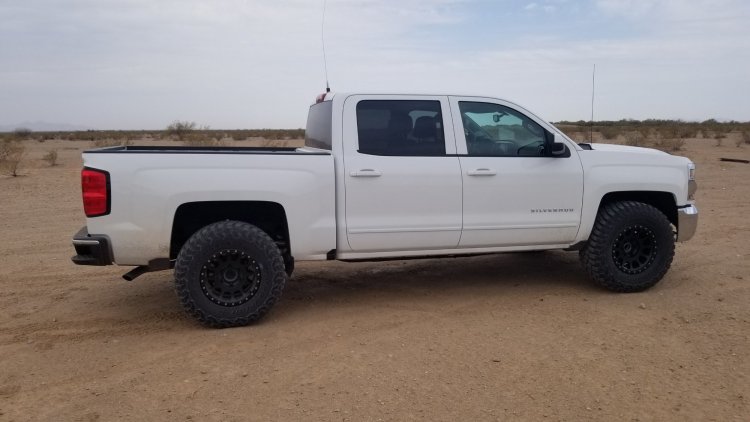

Suspension is on! First impressions are a nice planted and firm ride. Not too firm, more or less like you'd except a sports car to feel on the road. You feel inconsistencies in the road but not in a jarring, uncomfortable way.
Compared to the 2.5 coilovers I had on my 2015 Silverado, these are a bit firmer. I could see how some would dislike the slightly firmer ride but I love it.
Once everything was tightened down to spec and alignment was performed, the truck tracks perfectly straight and there are no new noises.
Here she is just after the suspension re-install and some testing in the dirt:
