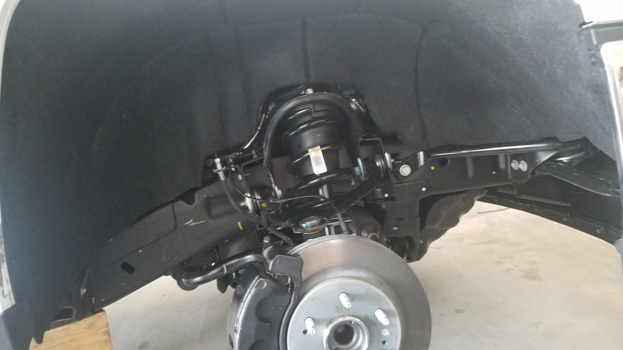

Thanks for the response. I meant a picture of the wheel well, sorry. Looks like you took out plenty of the liner, and some metal. Did you completely remove the sway bar, or just the links?
Oh haha sorry about that! I don't have any photos besides this one right now but I actually had to remove the entire liner for right now. I cycled the suspension for full bump and full lock and since I've been on a time crunch it was just easier to pull the liner and cut it up more later. I had to cut about 1/2" back on the firewall seam underneath the black plastic cap, remove the sway bar links, remove a few small brackets, some bending of the sheet metal so it clears at full compression, cut the lower portion of the liner pretty much all the way around and zip tie it back so it doesn't rub. Essentially this photo plus a little more trimming and pulling back on the cab side of the liner is all that's needed to clear to drive around town.
Hopefully this helps but I should be able to pull the wheel and take more photos soon.

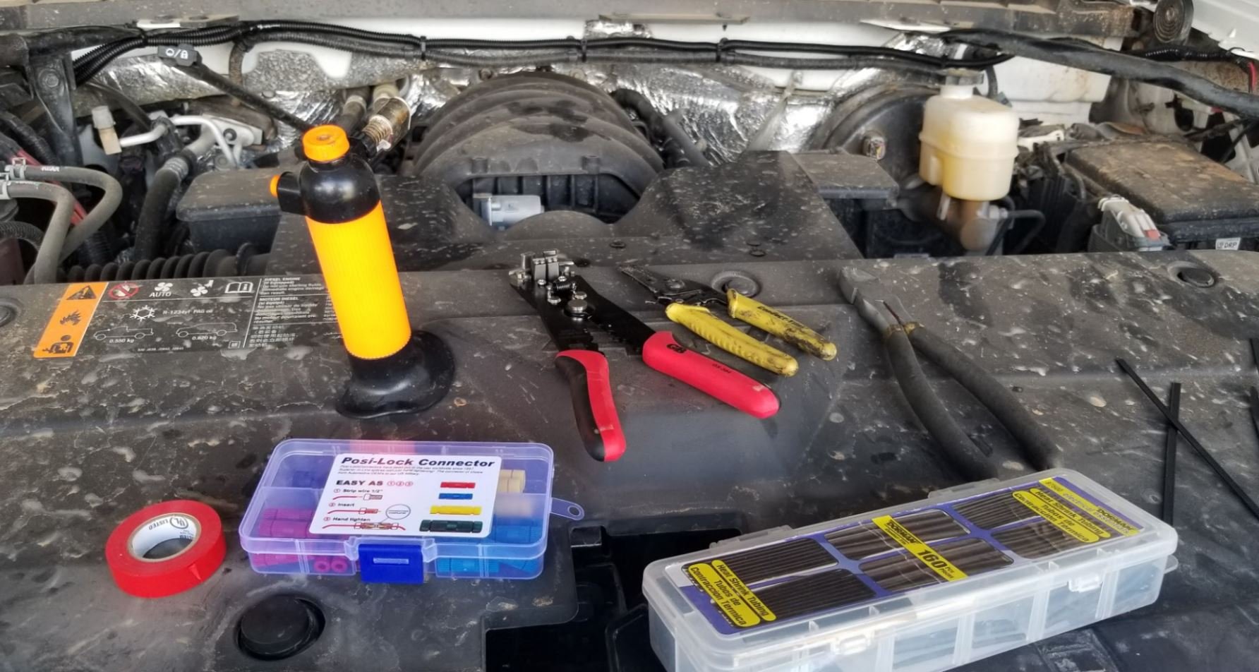

Since I wired my radio up at midnight just before a 2 day offroad event, it was a little rushed and slightly ghetto...
So yesterday I decided to redo everything and make it bullet proof. Tried out some really cool connectors called "Posi-Lock Connectors" and they are awesome! Stronger than anything else I've used as I couldn't pull the spliced wires apart. Hit everything with some heat shrink and insulated everything for that factory look.
One less thing to worry about knowing it was done right and will last for years.
If anyone is interested in ordering the little sample kit like I did, I picked it up on Amazon here: http://a.co/cZ8lR08
They're pricey but 100% worth it!
