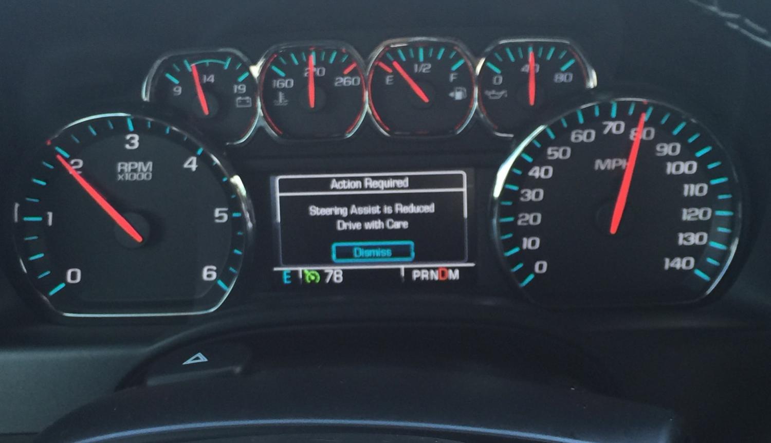

Brand new 2016 Silverado crew cab, short box, 2wd, 5.3L gas, with 20's.
Took it on a 1200 mile trip w/200 miles on it at home and our water bottles and human cargo were shaking at hwy speeds. Also, the electronic steering assist went out a few times at around 78mph. I'm guessing the vibrations were just too much for the steering computer to handle at those speeds. Just a guess.
We are at our vacation destination so I took it to a local dealer who did the usual checks for the steering issue and also road force balanced the tires. Took it out today for only a short ride at 75-80 and the vibration is still present although not as bad as before.
I'll be monitoring everything on our trip home and taking it in if it isn't to our liking.
I've got video of the vibrations as well as pictures of the power steering going out. Crazy stuff and I sure wish I'd have discovered this thread before purchasing.
Short video at hwy speed: https://youtu.be/bLdThKzOVzM
Picture of the steering problem (the camera "couldn't" take a clear picture because of the vibration) just FYI:
Wow that really sucks! Especially the steering.
